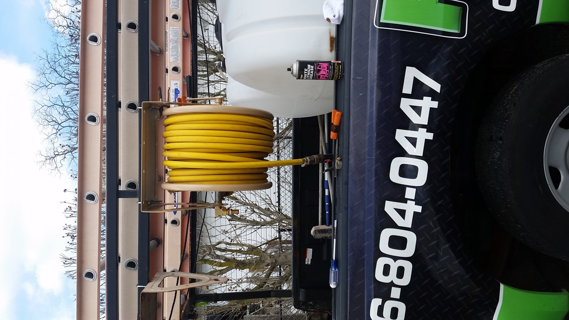

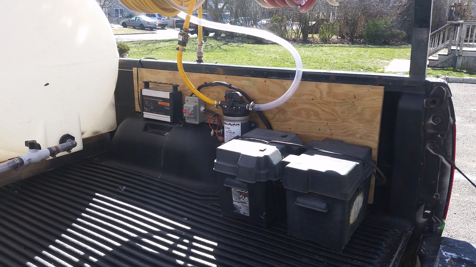

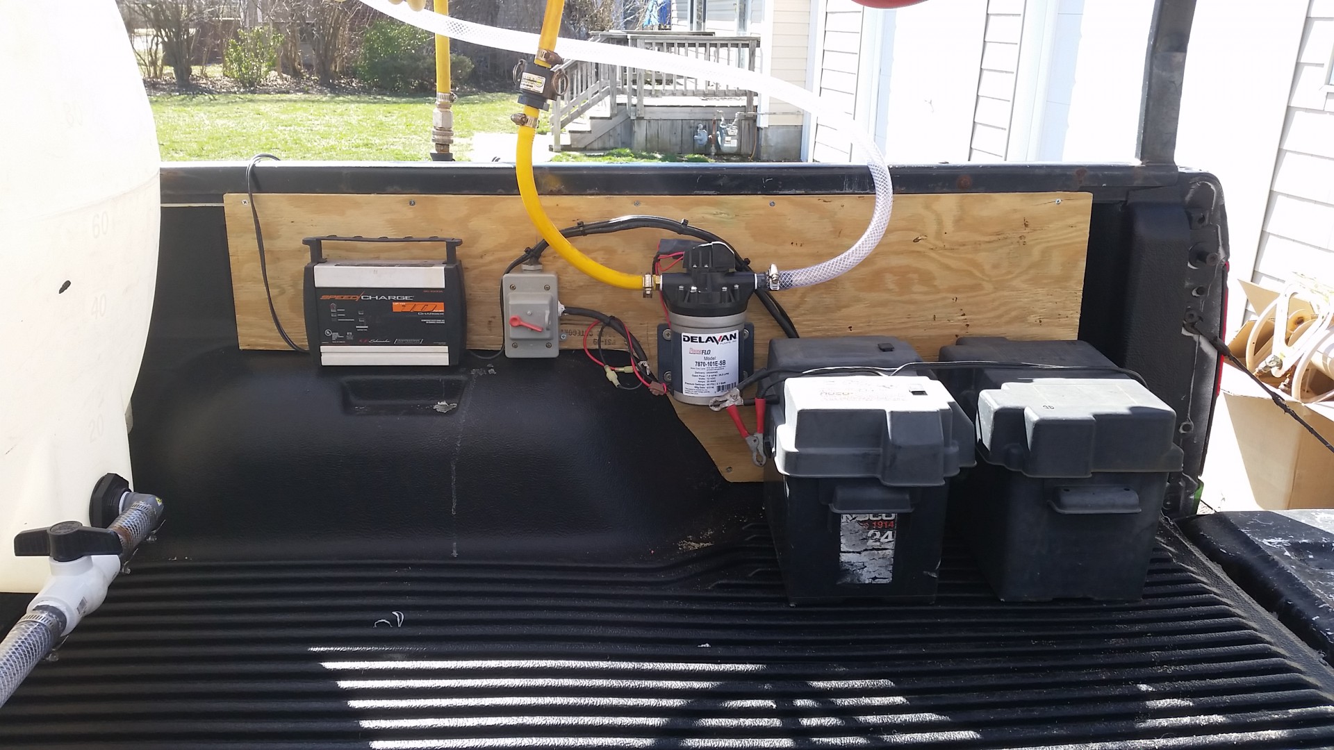

Are you using lock nuts on the u-bolts for the hose reels? I'm old so I can't see very well. Also, you might want to mount the roof pump up side down so if you generate a leak it won't flow towards the motor.
Mar 12, 2018
Nice set up.. and clean and neat.
Mar 12, 2018
waxman18324 wrote:
Erik,
Hank nothing gets by you. I have to swap the nuts on the ubolts as well.didn't think anyone would pick that up haha.
I don't think I've ever had a pump leak. (Everything else has) My pumps don't last that long, bolts holding down the head snap off in a few months and I exchange under warranty. Have 2 that have to be sent back sitting in garage.
Im going the dipstick method this year like you. What hose are you using on yours? This braided seems a lil stiff but it's also still cold out

DirtyRoofcom wrote:
waxman18324 wrote:
Erik,
How long is the inlet hose to the pump? The shorter the better. We use a poly braid 1/2" hose. You can use either 1/2" or 5/8".
Mar 12, 2018
Proportioner would be a great addition to that system
Mar 12, 2018
Thanks guys- I'm always open to different ideas and advice. I'm considering getting rid of the 2 large tanks and installing 3 vertical tanks and potentially the proportioner as I've heard nothing but good things about it.
Hank that inlet hose is 5/8 braided prob 10 ft long.
If you look at the tanks I have them piped together w valves. Right now it's set up so can gravity feed SH from the chemical tank to the mix tank by switch of a valve. If I decide I don't like the dipstick method I'll insert a T in the middle and plumb directly to the pump. I get my chemical pumped directly into the tank from the supplier so this gravity system works pretty well. I just turn the valve let it flow to the other tank while I'm grabbing coffee or setting up ladders, bags or hoses.

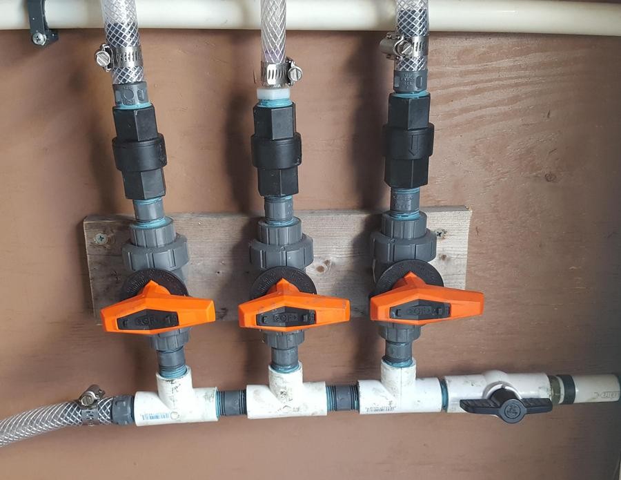

Here's another mixing valve that doesn't have a fancy box.
Mar 13, 2018
I wonder who Frank Peters really is ?
Mar 13, 2018
If I didn't have my mixing valves outside I would buy one of these.. not being in a box it is easier to see leaks or replace part's
Mar 13, 2018
I made my own and its way better then that. Plus the check valves I used have zero restrictions. Unlike them black check valves that clog.
Mar 13, 2018

this one has a 3 way valve for flushing with fresh water. you can also do it by moving the pickup tube from bleach container to water bucket
Art
Did you post pictures of yours
Mar 13, 2018
I would not buy or use that. They are not proportioning valves. Too many variable with that set up. Use only the gp valves when building a proportioner.
Mar 13, 2018
Yeah he goes into all that he even has a bunch of videos showing how the results are repeatable.
To be honest i cant see why a ball valve in good working condition cant deliver same results time and time again as long as you set it to the same position. i'm not looking to be super exact on my mix ratio. Half the time in the field its just a guess anyway as to how strong it is unless you start with fresh SH every morning thats tested and specifically measure out your water and chem and soap and your tanks are bone dry.
Mar 13, 2018

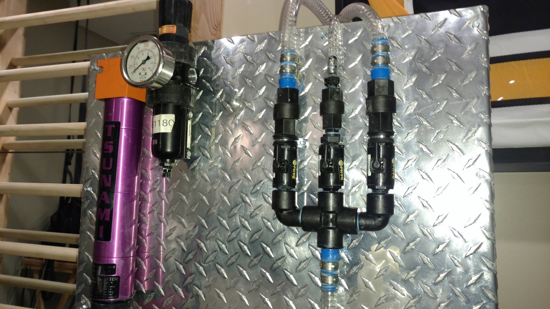

I like the metering valves because they are precise but also they have markings so you know exactly where to set it. Unlike those Micro valves where you need to make a mark on it to remember where your settings are.

The SH valve will be on a different position depending on the surface you are cleaning.
Mar 14, 2018

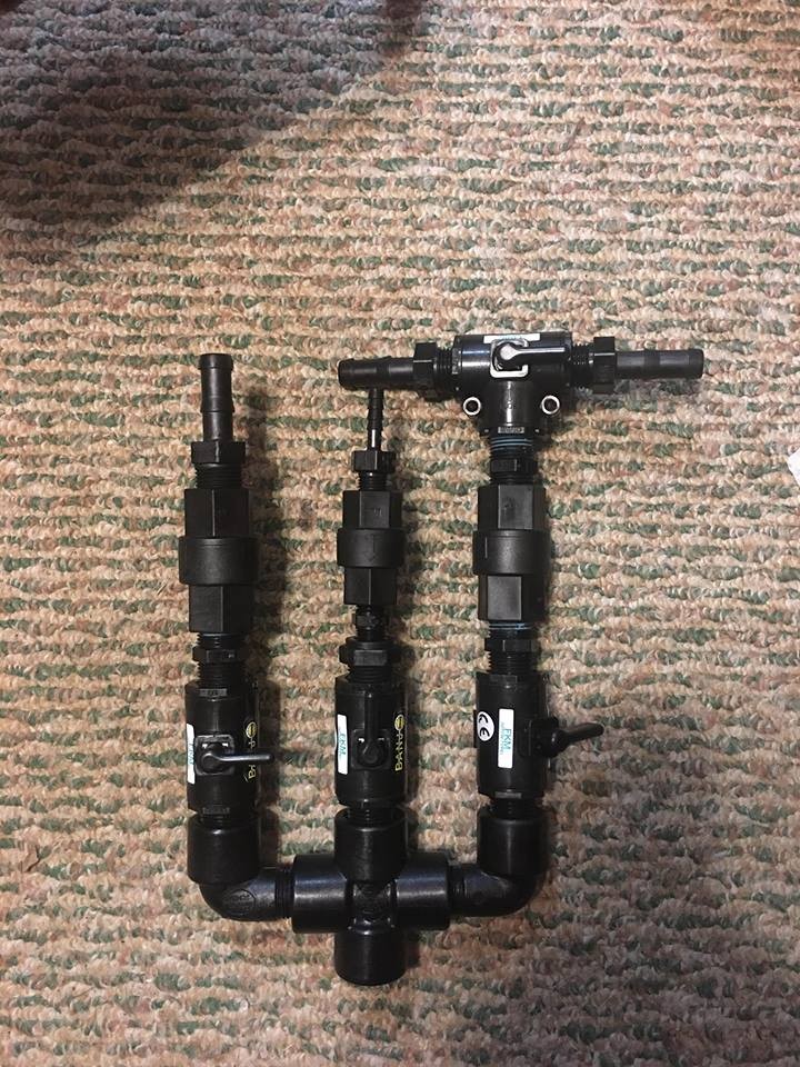

Here's the mixing valve I built. Incoming water to prime the pump and rinse when done.
Nice Bret, looks simple enough
Zach Maynard said
Mar 14, 2018
How much life are you guys getting out of those check valves? One of the ones I had last season had a missing spring. (The ones art uses with the flapper wouldn't have that problem).

Here's 2 that I made
http://www.nationalsoftwashalliance.com/t63087964/gray-34-check-valve/
Art that link is private
Fixed
