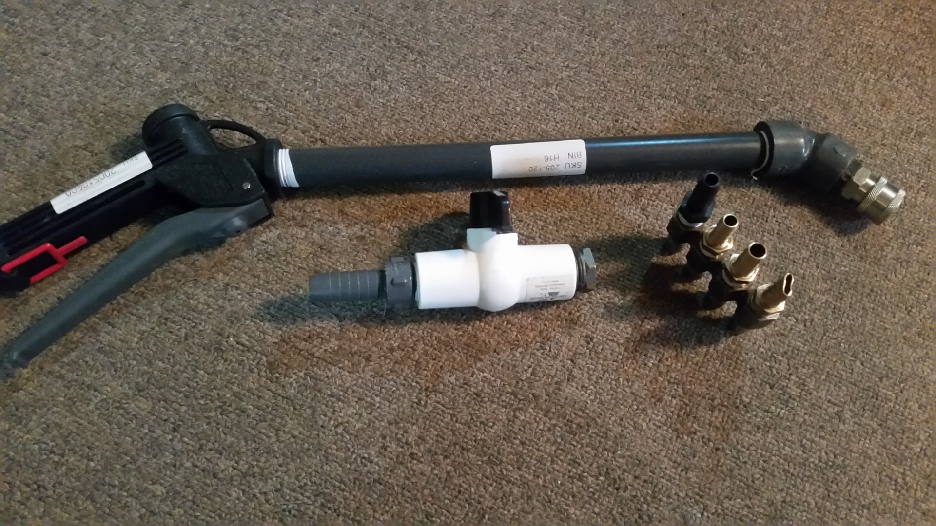

I tried different tips, the tip that stops the cycling is where I only get about 10 feet of height

are you sure you don't have a restriction somewhere . Let us see the gun you are using
Are you using a coupler and plug to attach you gun. Pictures please
I've been using the dual pump from power wash store.( Wow thats a big pic! My cam does 4k deffinition now, ( takes a half hour to upload vids to youtube now) Gotta love the s5!) Used to have the 4.9 gmp's with an accumulator, and a trigger gun very similar to the one in pic. . For this year I stepped up to the fatboy, and not going with accumulator. The bigger tips tried are on the 4 banger. The gun is a 12gpm. EDIT: sorry about the pic. I'm going to be out there tomorrow messing around with it again.

What is up with that Jrod? It's hard to see but it looks wrong.
Its a home made one from home depot
Mar 25, 2018
Is that connection to the ball valve small? Low flow?

Mike try to find a 5/8 x 1/2" thread barb to connect the to the gun. Put the hose in hot water and force it on

Why don't you just buy some real spray nozzles? A tip is only a couple dollars. That is loopy using tips like that, you are just going to dump solution everywhere. That is the first thing you need to change.

What in the wild world of sports are you doing? Don't try to reinvent the wheel.

Mike, I have no clue what you are trying to do but as Zach said, dump that home made stuff. You need 0030, 1530, 2530, 4030 and another with 0040, 1540, 25,40 and 4040... in that order. You are spraying 20' because your orifice is about 100! If you really want to have a good J Rod replace the 0030 & 0040 with 30 & 40 shooter tips.
I would send a picture of the gun we have because there is a place you can make another change. Dump that 12" nipple with a 45 and go with a quick connect straight from the gun. You DO NOT need that set up on the gun.
When it comes to cycling, it's an easy fix with the 0030 tip and an allen wrench.
