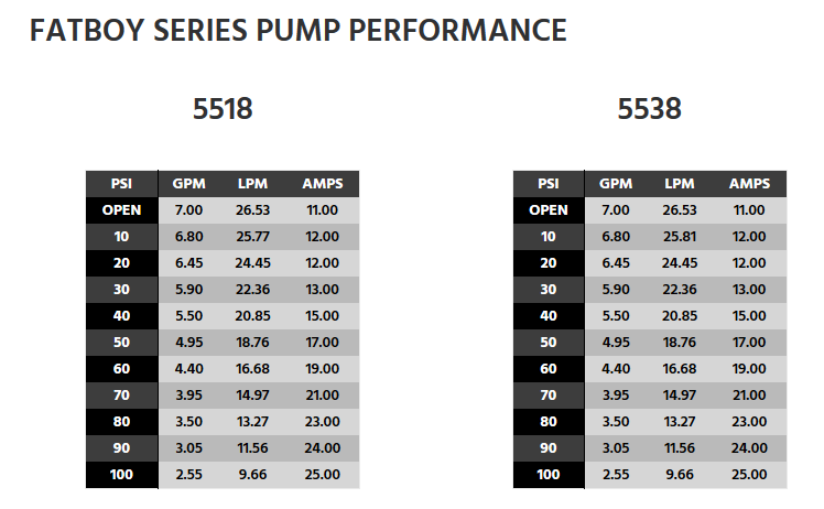

Fatboy:3
Is this the same as the Remco Proflow Fatboy seen here?
It looks like the standard FB but painted black versus blue. Looking at the specs I'm not sure there is anything different about it. It might just simply be brand labeled.

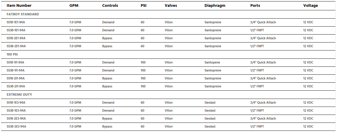

I just took a closer look. It can be ordered with Viton valves. I am a bit concerned about the drop with PSI. Northern Tool for 200.00.

The table indicates the diaphragm on the Extreme Duty pump is constructed with Geolast. Is anyone familiar with that?
Apr 26, 2018
Its supposedly buna and polypropylene but on a chem chart i found "no data" for SH
