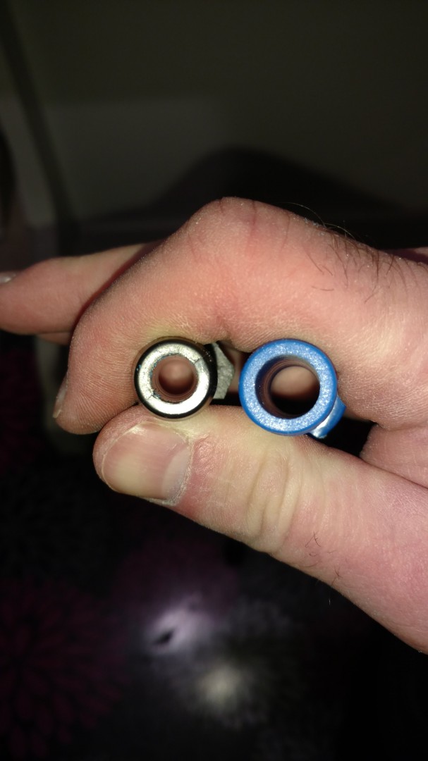

Good find Jason. I found these 1/2"npt at Home Depot near the Pex stuff. They are schedule 80 and have a larger bore than the banjo. They are like $.39 each.

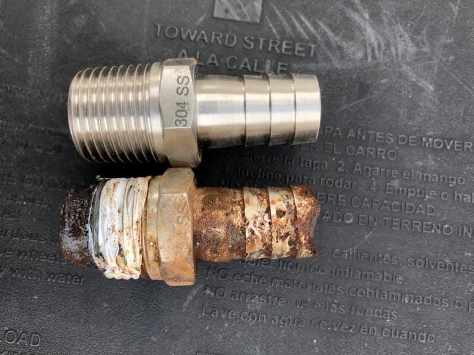

They last a little longer, but still need to be changed out. Bleach side tank
Didn't you just get those??? And they rusted that fast?

Not sure how old they are, maybe 3 or 4 months. Nothing holds up for long

Why not schedule 80 PVC barb?
Jan 8, 2020
Yea,..I was wondering why not use something in the plastic line,..like Brett said,..schedule 80. Sometimes there needs to be places where strength is more important. But that usually pertains to something in the pressure washer side of things. Like hose reel fittings,...but I don't think that is the case here.

These Hose barbs aren't cheap, but they hold up way better then brass
