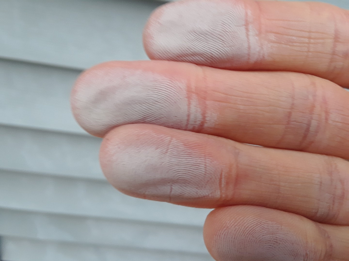

It WILLl look blotchy and inconsistent when you are dealing with Oxidation....only thing you could do is brush it out and remove the oxidation.

Grey and blue siding are the worst for this. This is what they get before the job:
"Soft washing will not remove the oxidation on vinyl siding but will clean all algae and mold from siding and metal. Oxidation causes your vinyl siding to look faded and white or chalky. This chalkiness is actually Titanium Dioxide being released as your vinyl degrades from UV exposure. In order to remove the oxidation, a different cleaning agent is applied with our low-pressure system and brushing each piece of siding is required."

Oxidized surfaces should never be cleaned using high pressure. This can cause striping, uneven cleaning, and damage to the surface. Our Soft Wash non pressure cleaning process is used to remove Algae and other Organic stains and as little of the oxidation as possible. As the surface dries after cleaning, and due to this pre-existing condition, oxidized or faded areas may reveal stains underneath weep holes of siding, irregular spotting of the surface and other surface irregularities. While the surface will be clean, we cannot guarantee the final outcome or be responsible for these inconsistencies.
