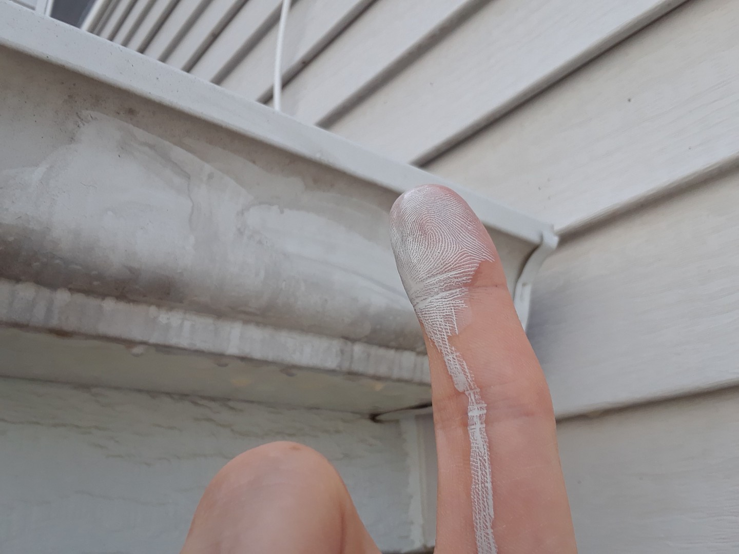

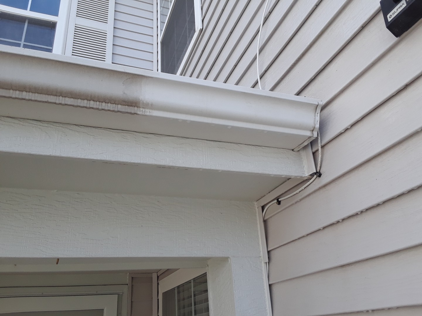

I ran out and purchased some Totally Awesome at the local Dollar Tree Store. Attached are photos showing before cleaning, cleaning at full strength and cleaning at half strength. As you can see, at full strength it takes a good deal of paint off. I started out diluting it 1:10 per the instructions for oxidizing paint and the oxidation didn't budge. I progressed to 2:10 and then 3:10 and then 5:10. 5:10 seemed to be most effective without leaching too much paint. And yes I did have to lightly scrub.

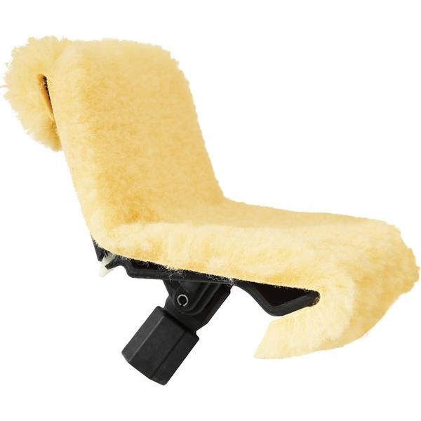

I use a curved gutter "applicatior" like Marxsoff (detroitsponge. com) dip like a mop.
I would love to find one that the head pivots 2 directions.
if anyone know one please post!
Nice find.
