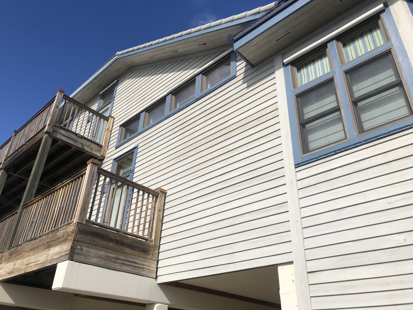

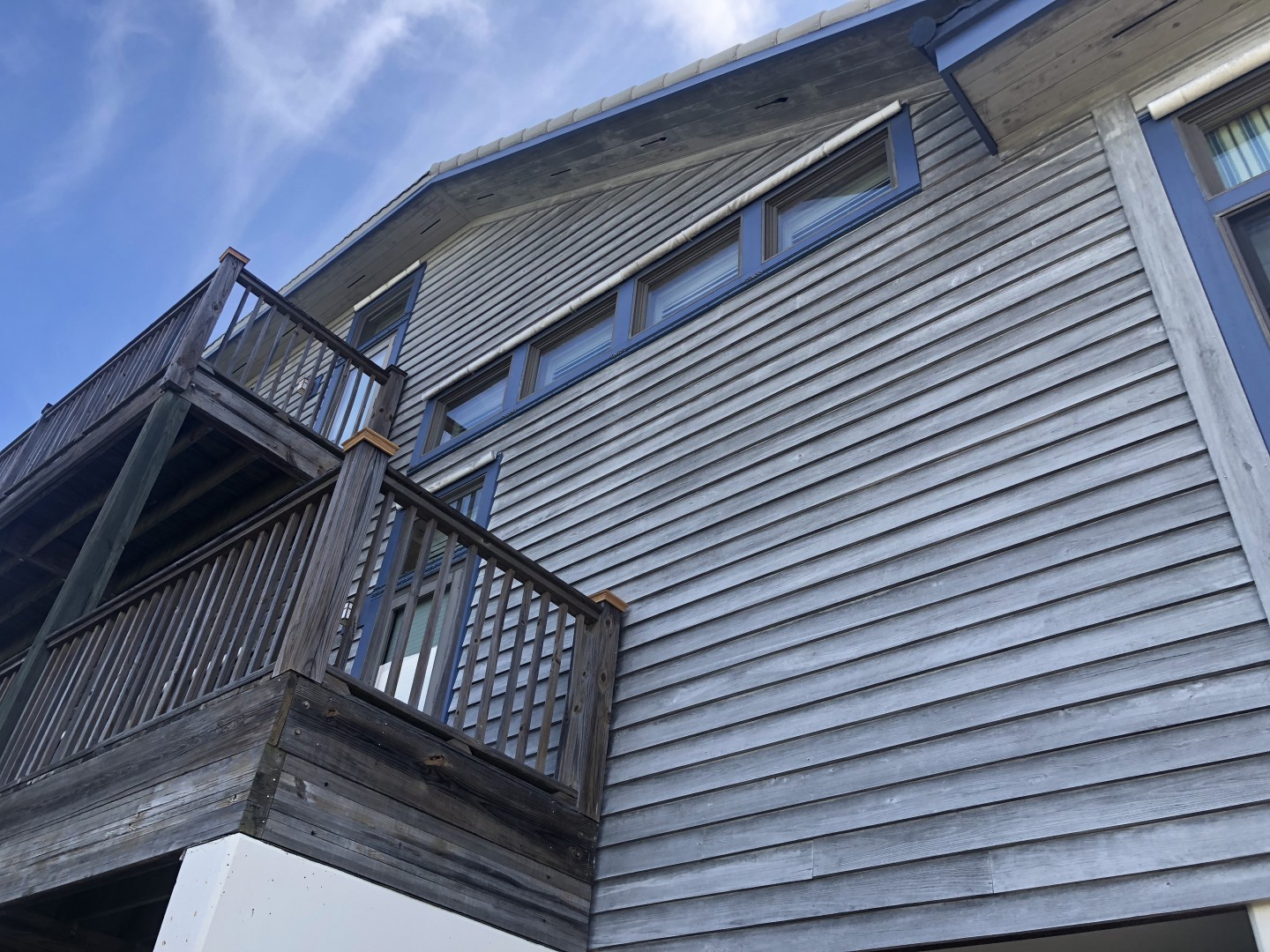

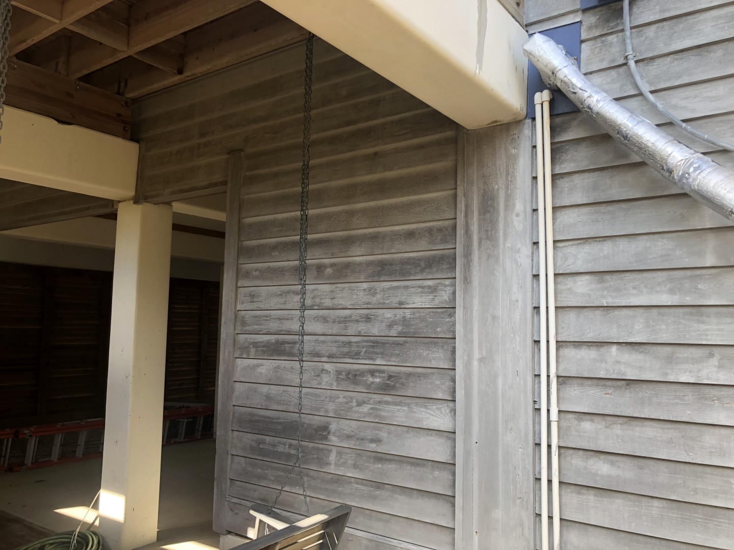

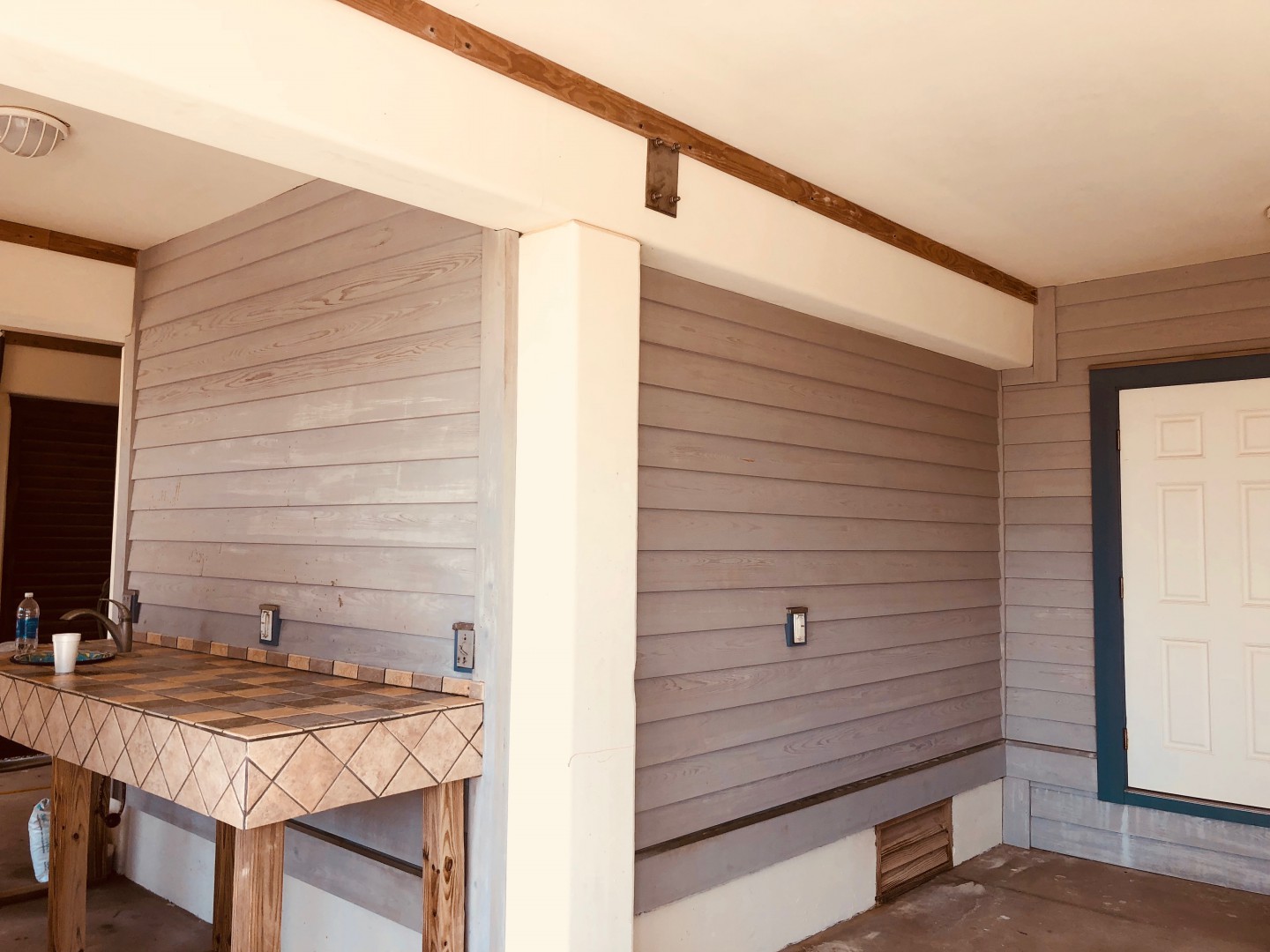

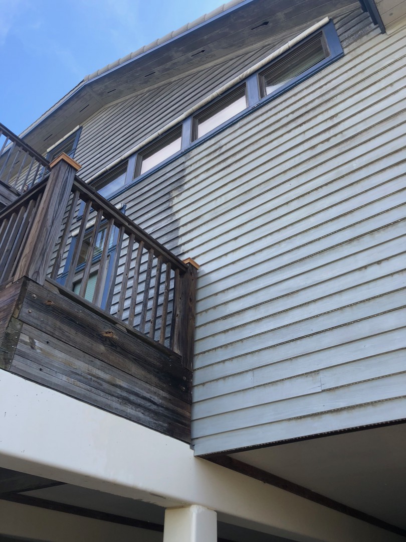

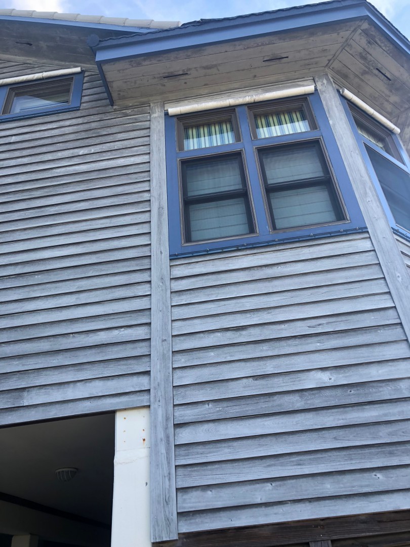

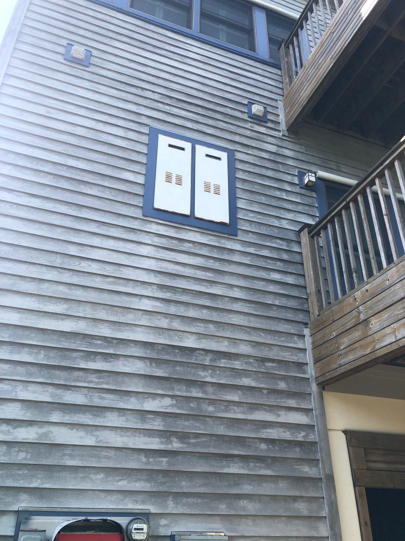

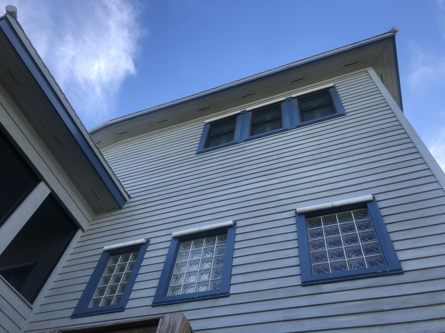

We settled on a price, i cleaned it, and we communicated some more. I sent hie before & after photographs.
Fast forward to Friday I received this emial:

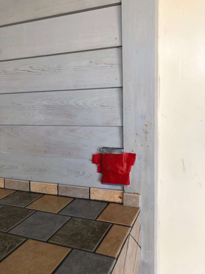

I have no clue why that little side wall next to the swing is streaking. It might have something to do with crap leaking
on the overhead joist or beam. I’ll climb up and look. Don’t worry about it.
The MX-3 application sounds about right. We’ve about decided that your cleaning was so good we may not have to
repaint for a while. What do you think? I have an estimate from my local painter that is about $$ right, so I’ll
need to let him know soon.
Thanks again for your help.
Cheers, *****
He did ask me to put at mildewcide (MX--3) in my final rinse water, and I obliged. I purchased it from Amazon. I honestly don't know if it did squat, the house was cleaned by the time i sprayed it on there. Maybe it will have some lasting effects....who knows?????
