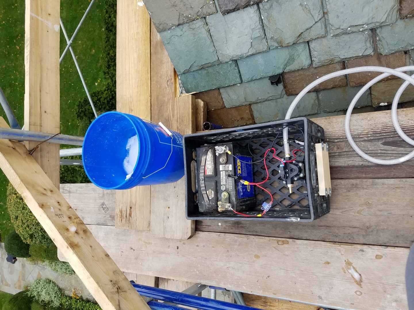

My chem application pump went so last minute build for monday!

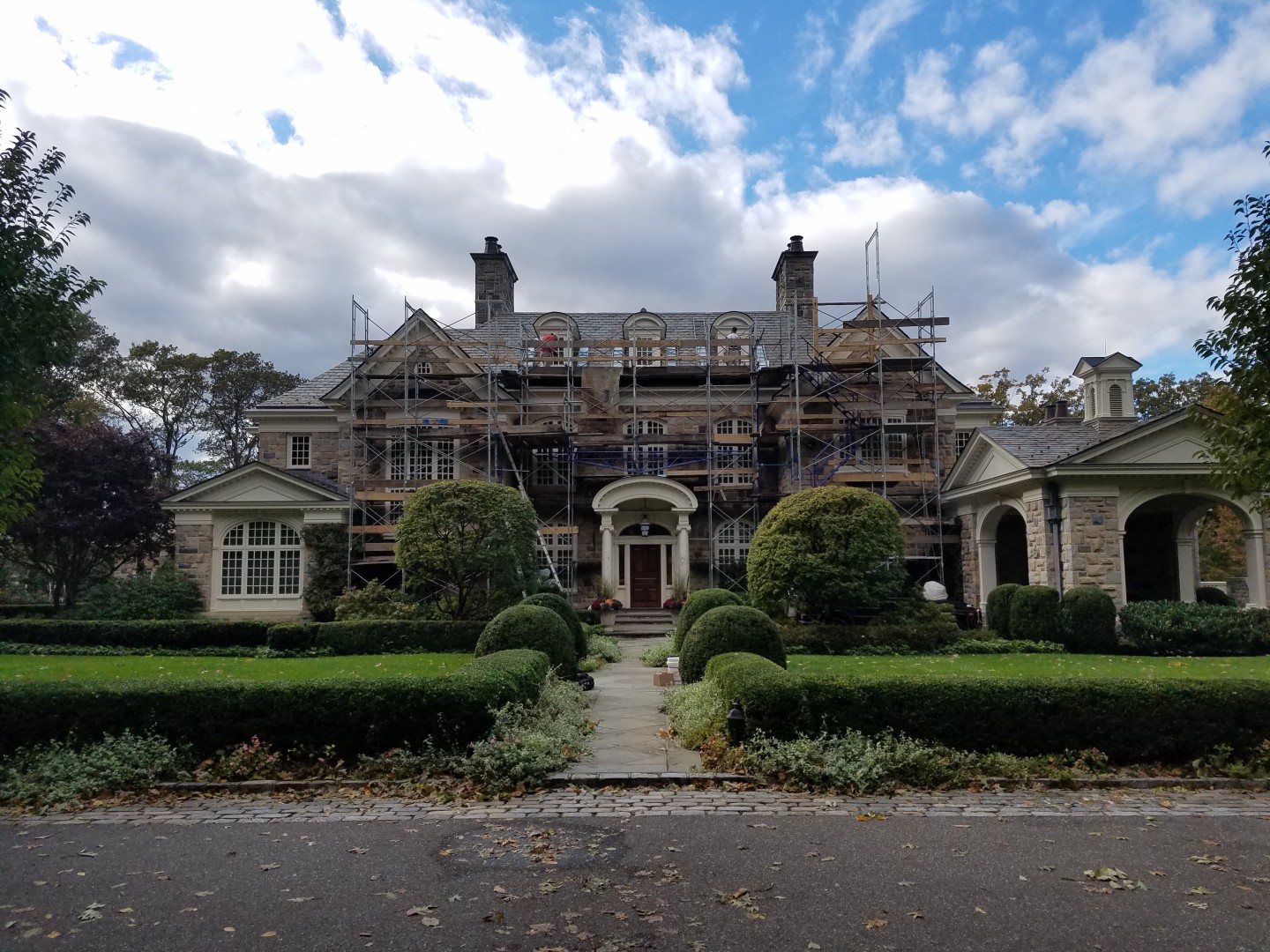

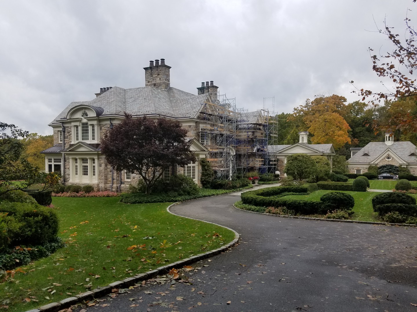

It's for use as a chemical pump for controlled spraying, small jobs, or in this case, we are working off scaffolding since theres a lot of carpentry repair, pointing, some slate tiles replaced.
theres 5 buildings on this property so this is easier to lug around.

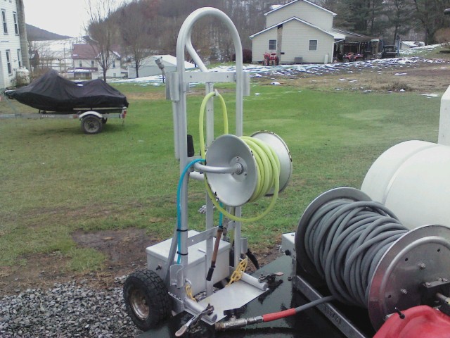

On this subject,..I built an aluminum hand truck sprayer for this past season,...I posted pictures of my original one a few years ago,....reason for mentioning is I also used 2 GPM pumps with 50' of 3/8" Tundra Air hose,..(Very Flexible) Also used FlexZilla as experiment. Anyhow,..I started using 1 GPM pumps,..with little to no loss in needed performance,..and uses less material,...I use my sprayer for gutters 80% of the time,.so to much chemical and it just runs off. But still works plenty good for when I need to use it on composite decks etc,...

Here's a quick picture of the sprayer,...very nice for filling the void where DS'ing isn't enough,..but roof rig is over kill,...and an awesome maid cart,..holds two brushes upright,..has a hanger for the PW trigger,..a 12" extension holder for when I use the rotating nozzle,..which is also on board,...and a 5 gallon bucket sits on the cart,..usually gutter cleaner,..but was used for many different jobs this past season. It rides on the trailer held down by toggle clamps,....the toggle clamps go through the bucket cradle. The hand truck tray sits on a bracket that is out of the picture,..and it takes all the weight,..the clamps just keep it in place.

my setup was a quickie but also temporary till I build it right. Thinking of a motorcycle battery or Li Ion made for deep cycle (theres plenty options out there now).
If I go that route I may have a 20lbs hand held unit

Hey Maverick,..nothing wrong with a 20 lb. hand held,...that's what my hand helds weigh with a full gallon of cleaner. They are used sparingly so no big deal. The more I used mine the last few years I realize the convenience. I have them and also the hand truck sprayer plugged into the van,..and never have to manually charge them,..they are always charging while the van is running.

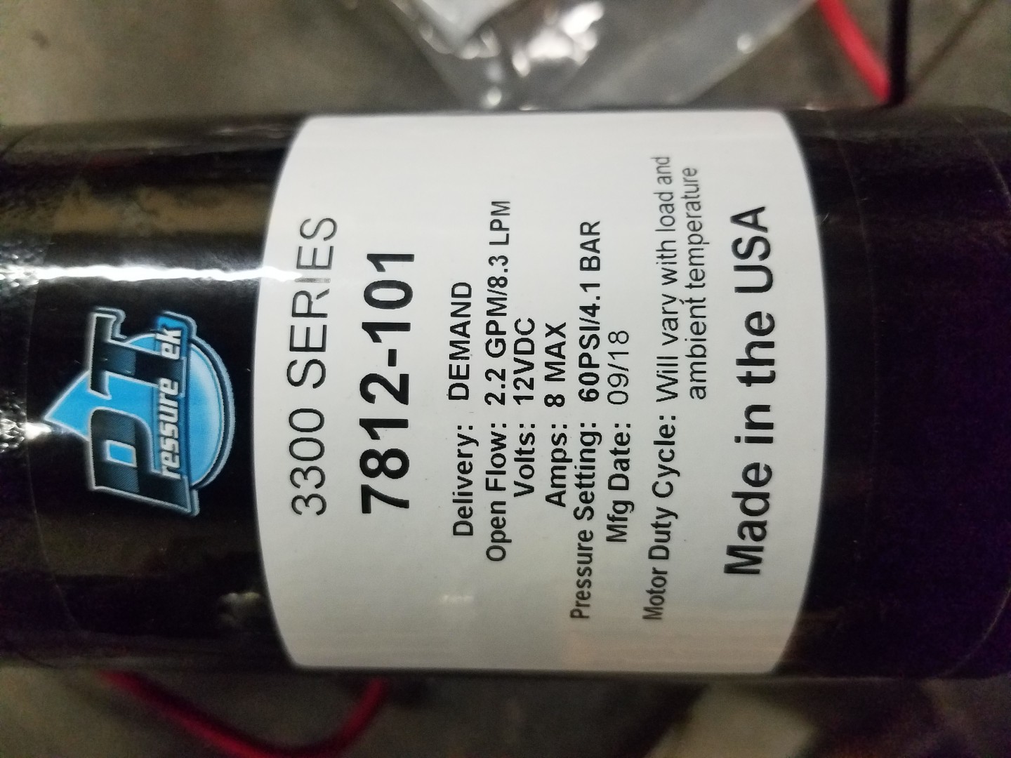

purchased a 2gpm Delavan pump
rated at 8amps max.
Usually I purchased prewired and my 7gpm fatboy is rated for abt 26amps max but was prewired with 30amp fuse.
Should I wire inline a 10amp fuse or other?
