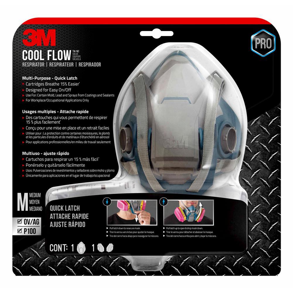

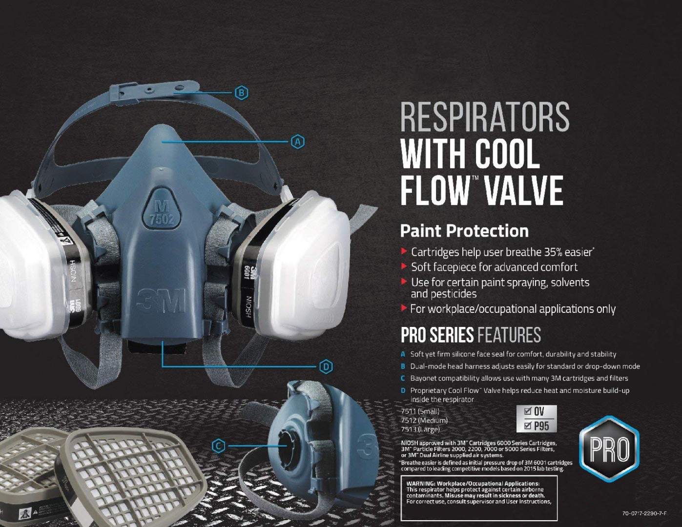

those charcoal ones are good for things like latex odor, and may stave off some of the smell, but not enough charcoal to scrub the chlorine gas that can be harmful.
the half face marks with "cool-flow" work great for not fogging up glasses, exhalant breath vents fully under the mask.
check em out
-- Edited by Maverick Contracting on Wednesday 14th of November 2018 05:13:12 PM
check em out

I use a respirstor similar to what maverick posted. Does an excellent job

This is the face shield PAsoftwash has been using for two years. I like the fact it can be unlatched and dropped down with ease.
Need to make a quick phone call? Need to gently admonish a ground tech? Need to visit with a customer? Very easy to do. Latch it back up and spray away.
I was not aware it was available at home depot. That should make getting them easier.
-- Edited by Steve Salley on Tuesday 4th of December 2018 09:48:25 AM
My guys love these. We have been using them for 2 seasons now and they are easy to get...Home Depot. The initial cost is around 60 buck, but the refills are like 18 bucks. My guys usually get a couple weeks out of a fresh one.

Brett: The one you recommend is rated for OG (organic vapors) which is what SH and dead dying algae is putting off. I'd say it does;t offer the safe safety factor as a P100/OV/AG (100% filtration, organic vapor, acid gas) respirator, but it certainly is better than nothing!

Thanks Ray. Getting them to wear what they need can me a daunting task at times. Since they are seldom on a roof in the midst of heavy fumes, they will wear these in the heat w/o complaint and since 3M says they are good for SH. The more confined they will wear100% filtration.
BTW: After posting I called 3M to make sure I was doing the right thing and since we are not in confined spaces they said these masks would do the trick.
check em out

Steve,
