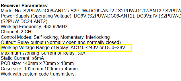

I dont see where you can use that for 120volts.
I found this in the details. I like the antenna.
This one has two relays. I would rather have one unless the second could be used in the event one goes bad.

Hey Mike,..here is the AC model:
http://www.carymart.com/3-miles-long-range-remote-control-kit-two-30a-relay-output-feedback-function-p-1978.html
