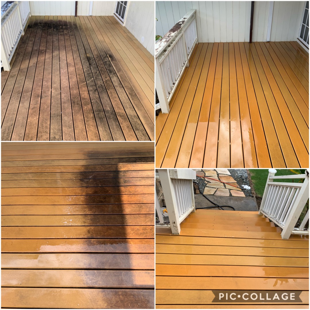

Aloha everyone! Last job for the year was a small IPE deck that we soft washed with a 3% mix. We applied, let dwell for 10 minutes with a little agitation and rinsed off.
BTW, did you apply an acid to neutralize and balance the PH?
Not only does it neutralize but "brighten" back to original color.
Even if you didn't, looks like you did!
Will you be oiling it after?
if so it will only last a year or 2 before "graying" due to UV Ray's.
Untreated it will "re-grey" within a month with heavy UV or up to 4 months in low UV times of year.
It's an easy upsell and repeat work.
I redo several big oceanfront estates every April just before Memorial day so the owners can enjoy (and entertain) the whole summer with friends in the Hamptons.
Chris, you're killing it in Hawaii!
Maybe I'll have to fly out there and help Paradise Pressure Washing LLC!

Great up sells you have but we just cleaned this area due to customer cost originally I was supposed to soft wash the whole house but client only wanted to pay a little bit. Any time you want to come I’m sure I can find some work for you! If not we like to eat and drink a little over here lol
Dec 30, 2018
Well I'm sure you will be called to reclean at some point since you did an excellent job .
worth offering the upsell.
Whenever you can upsell a current customer, you can double/ triple your income without having to invest in advertising
