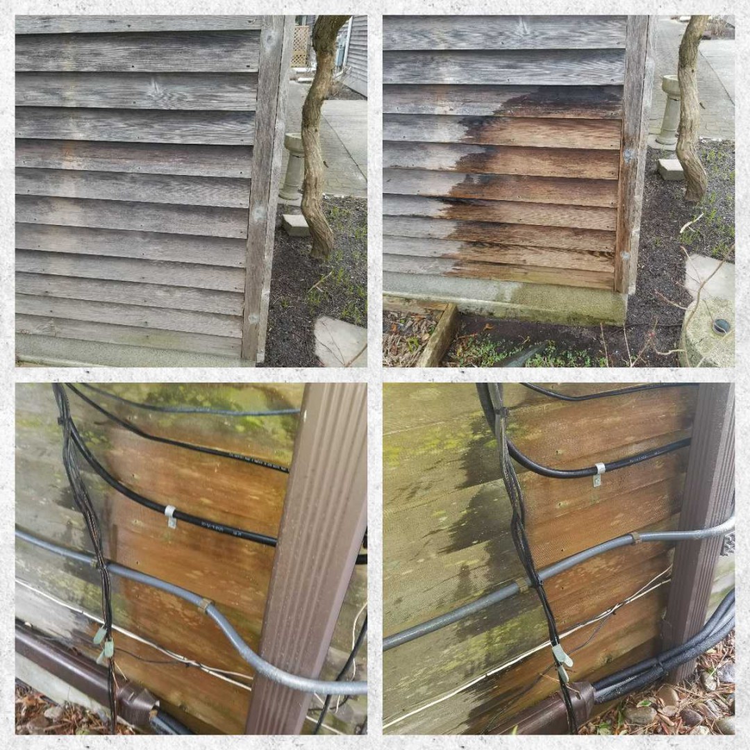

I was wondering about a strong Sodium Percarbonate mix, like 1 pound per gallon directly applied to the surface, 15 or 20 minute dwell and rinse, maybe it would kill the mold and algae at that strength?
There is a guy in California that washes houses with Oxyclean and hot water, uses a small tub (3 or 5 pounds) of Oxiclean into a 5 gallon bucket of hot water, directly applies this to houses then rinses and claims (I don't know for sure about this) that this with the hot water rinsing helps get rid of the mold and algae off of houses.
I have been wanting to try this out to see if there is any truth to it because there are some houses here that they put a ton of plants around the house that I am sure will start dying when I take the cap off of the bleach tank, before I even spray some of these houses. I would like an almost fool-proof way for some of these houses to get the surface clean without bleach or high pressure but have not found anything but talking to this guy makes me think there is a chance it might work.
What do you guys think?

Hey Chris,..I'd say the guy using OxiClean and hot water is relying highly on the use of the PW to to the real cleaning. Probably gets work this way by using non smelly detergent.
I used Hydrogen Peroxide in commercial strength to try it on basic black wildew you see on siding,..even at full strength it wouldn't make it disappear. It was around 33% I think and thick like paint. It would burn you skin. Ended up giving it to a friend of mine ho used it for bleaching deer skulls. Worked great for that also.
