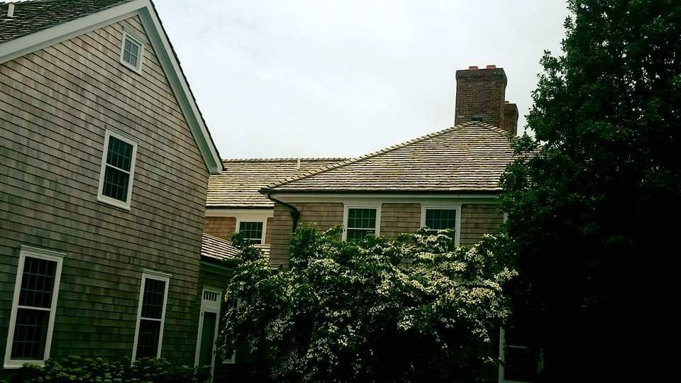

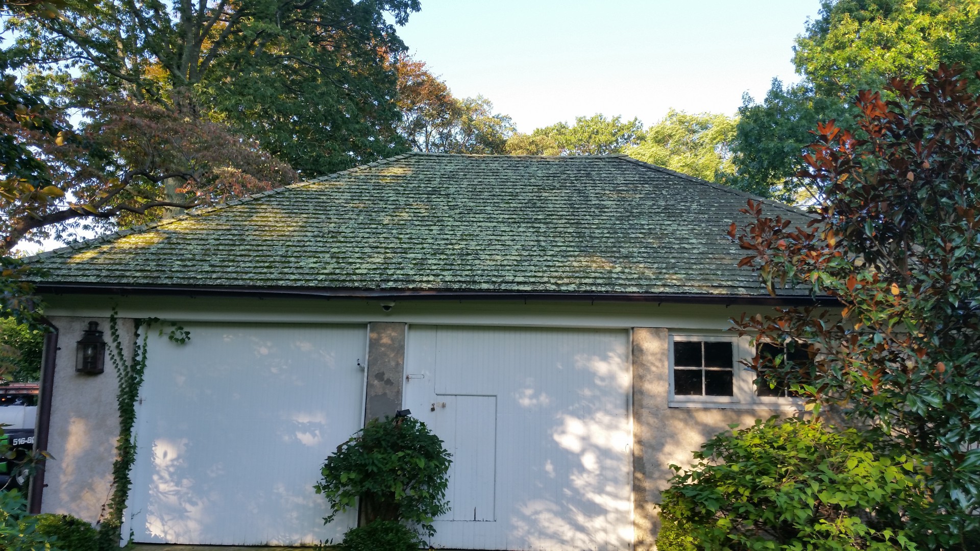

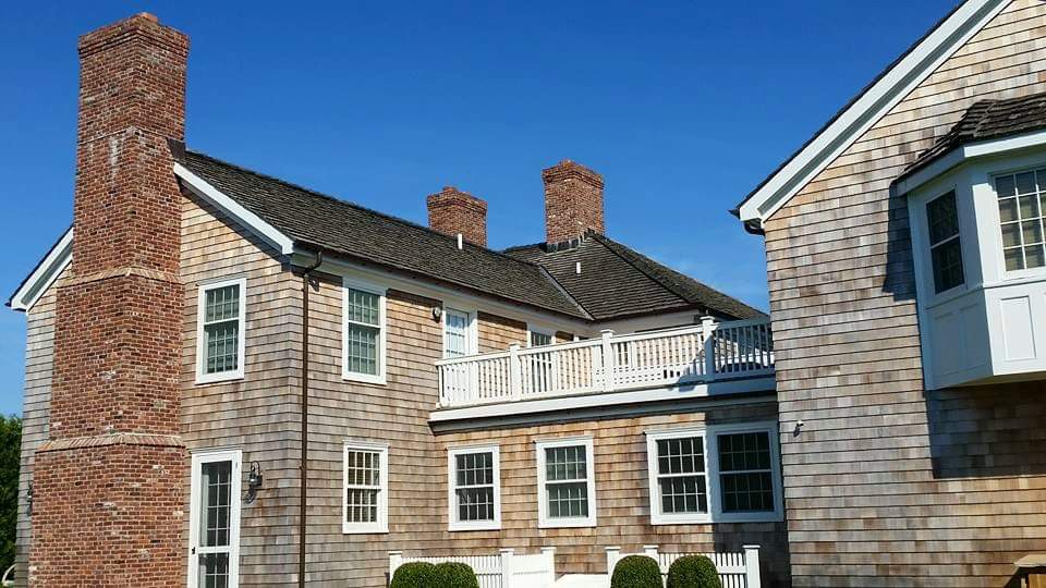

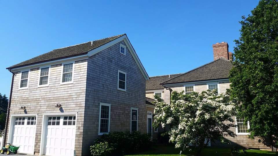

FWIW. if you haven't cleaned cedar before I would not experiment on a customers house. Depending on your location (that is not in your signature) and the amount and type of vegetation typical of your area you may be surprised at the amount of work needed to get only decent results. You need to set customer expectations and that is hard to do W/O the experience.
Another factor to consider is that most homes that have cedar roofing tend to be very large and often times complex roof lines. It is almost impossible to clean a large cedar roof w/o gettin on it. You just cant do it from the gutters edge.
As for pricing, noone here knows your overhead costs and other expenses. With that said it should be a lot more than asphalt.
House in the pics is one of our customers. We only agreed to clean the 1200sf carriage house. The main house wasnt bad and frankly was to tall and complex to access wo a lift. That cost would have been too much for them. The carriage house rinsed properly took 2 days (one side had A LOT of lichen)
Just curious Erik. We have never gotten on a cedar roof and we have never had one take more than a full day and some have been pretty big. Why would something relatively small take so long?

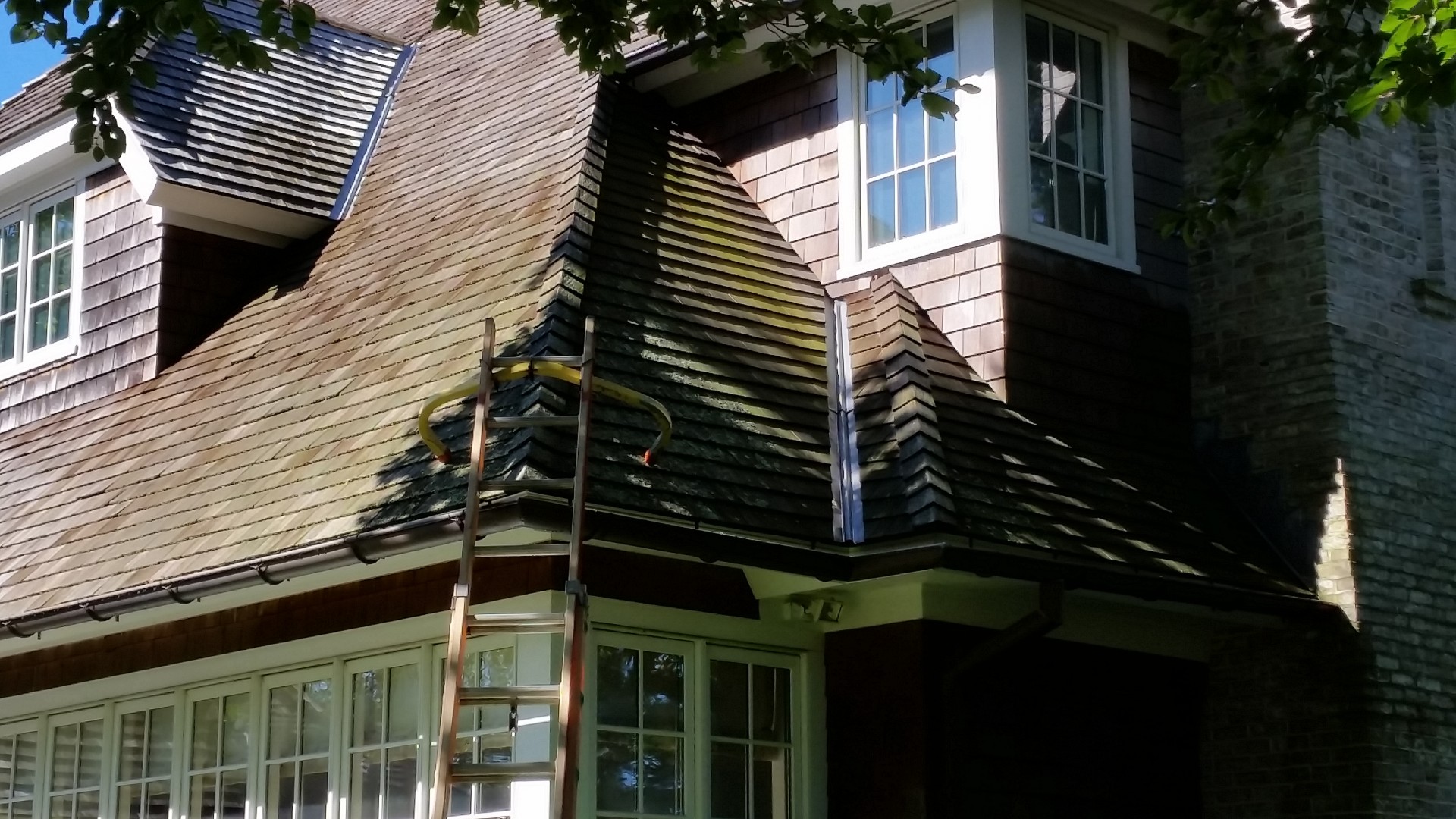

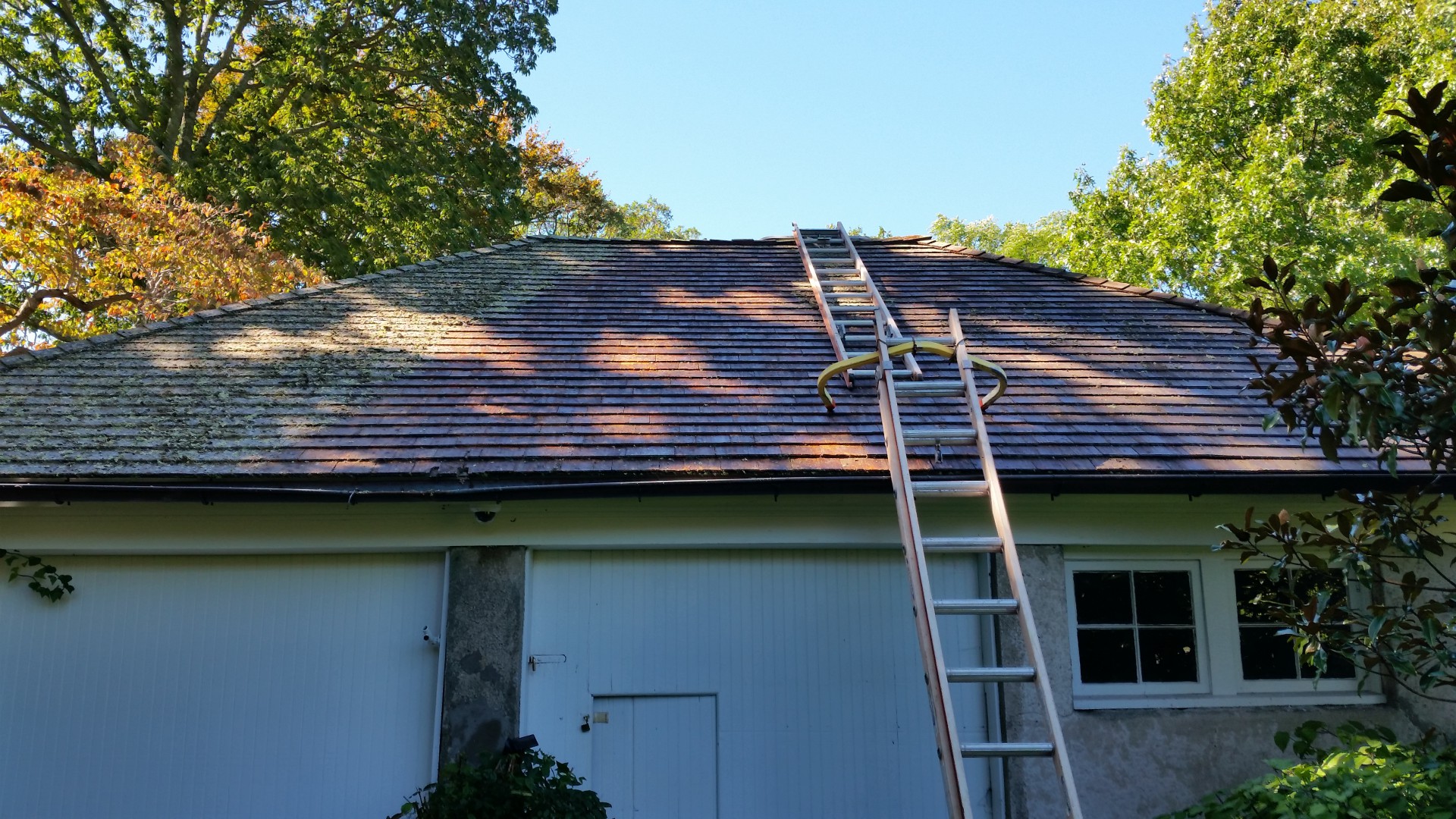

THE RINSING. trying to remove (after treatment and dwell time) most of the moss lichen And algae film to leave a decently clean surface behind. I guess it could be left to fall off in it's own naturally but then there would be distinct differences in appearance down the road. Areas with lots of growth will look different then the areas that didnt have a lot of growth. maybe a second treatment later could help alleviate the issue.
My experience cleaning cedar has not been great. I dont know if it's my own very high expectations or how bad the roofs are that weve done, The roofs weve done just seemed to have the moss and lichen embedded in the shingle/shake. We just cant seem to leave a product behind that "WE" are happy with (customers are happy and satisfied)
I'm interested to hear what others have experienced. On both siding and roofs.
Here a photo of extreme lichen growth and a couple photos of a home that's massive and a lot of parts where very difficult to rinse even with a booster pump.
