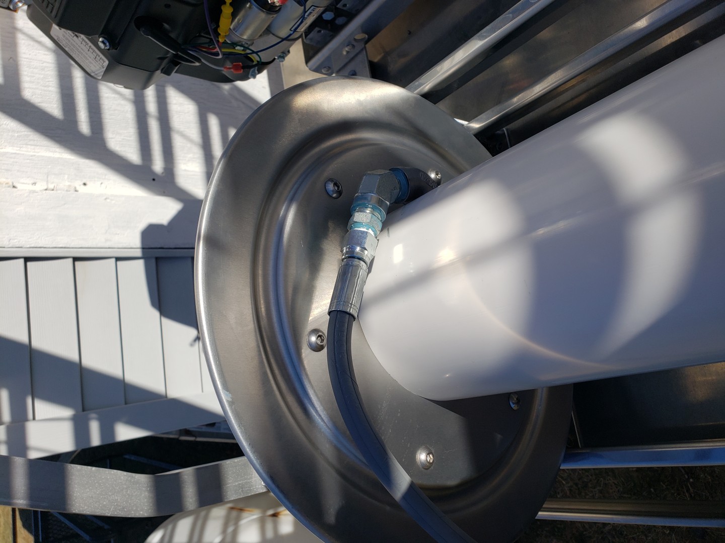

Not happy at all w how the hose is sitting. I used a street 45 and then the bushing. I haven't tried it but it look like i would be better off just putting the bushing directly onto the 90 on the Proportioner

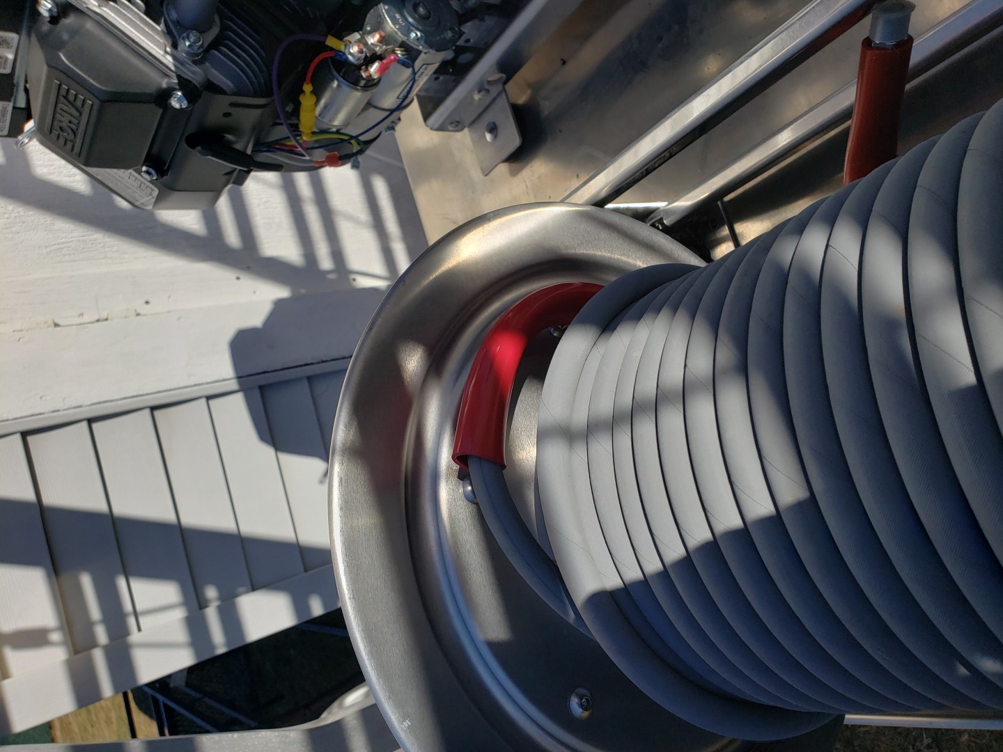

Erik,..I addressed this issue several years ago,..I never liked the way the hose connected to the hose reel neither. There is a very simple fix,..just turn the hose reel elbow so it's running inline with the core of the reel,..then when you attach the hose,..it will be coming straight out,..and along length the core of the reel. Then it's easy to give a gradual transition when winding,..and doesn't have that "uncomfortable" looking connection.
You just need to remove the 45 you added.
I prefer one section of hose on the reel. This is more preference than reasoning. If anything though,..I like the smooth drag of hose over any terrain, without the coupler getting snagged. Also leaves a lump on the reel.

Jeff I follow you! I thought about turning the fitting but didnt try it. I'm going to either do that or make zip tie the loop on to the hose reel side.
1 hose would be ideal but a lot of people said 2 separate sections in case one goes while working tou still have the other. I have 2 100ft hoses.
Wonder if their is a coupler that has a 45 bend to it??

For connecting two separate lengths we use this 3/8 steel connector to connect two 100 foot hoses. Keeps hose flat on reel. I am sure you could find them locally....
