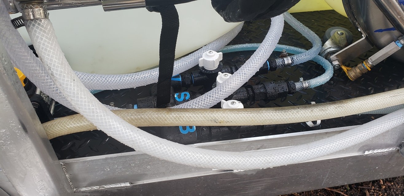

I put it all together today and tried it out. I'm finding out the same thing about the soap. I've only got half hour into this and barely had the soap valve cracked. Too much soap? This is coming from a guy that has been bleach and water for a few years now, lol. How much is the right amount, lol?
Pic included of where I placed it on the trailer. Should have this figured out, and fine tuned soon. Thanks for the help with the initial settings for the metering system. Was on point!
You dont need a ton of soap in most cases. Too much will be a PITA to rinse on houses. In steep roofs I bump it up.
I have 1/2" valve w 3/8 line. Pinalen is a little on the thin side and I just crack the valve open. With a thicker soap inwould prob have to crack it a lil more.
