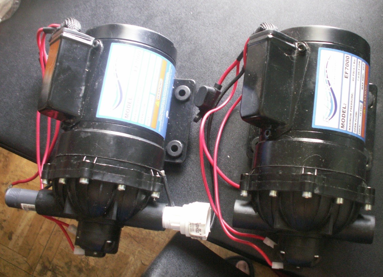

Has anyone tried using two pumps in parallel to increase GPM output. For example, If the flow rate through a 3/8 inch hose 150 foot long at 50 PSI is less than wanted, would paralleling a second pump (same model) increase flow by a noticeable degree? I am actually using 1/2 inch PVC hose for the first 100 foot, and adding 50 foot section of 3/8 inch to the end to have a total of 150 foot. The object is to reduce the effort required to apply the mix by using the lighter weight hose. I would be tempted to expect the GPM to double, but I'm probably missing some important factor. Thanks for your thoughts, Chuck

I went with the 60 psi Everflo EF7000 1/2". I got two pumps to have a spare on hand. Recently I got the notion to use some 3/8 inch hose to make dragging my hose around easier. The additional 40 psi out of the fat boy pump would surly increase my flow. So my 100 foot 1/2 inch pvc hose (300 pound) arrives later today. I'm going to set up a test on the bench to see where things stand using the 100 foot 1/2 inch followed with 50 foot of 3/8 hose shooting into a bucket. Maybe the flow rate will be sufficient without any changes. I plan to test with the hoses coiled up which should represent a worst case result. I am anxious to get things operational. Has anyone tried using a standard room light switch mounted in a standard plastic box to supply power to the pumps? Final trailer layout is still in progress. Bought some yard signs. They are double sided and my final cost per sign with shipping was $7.50 each, Only got 10 pieces.

Electrical switches work fine, not sure about dual pumps. I never had a need for it. !/2" hose works best because of the weight. 5/8" works better for flow 3/8 would give you less flow

Hi Art, thanks for the information. In the beginning of this project, I believed the most important aspect of soft wash for me was to get the maximum amount of flow possible. So, I ordered some 3/4 reinforced hose for the pump input using a dip stick to the tank. After some reading, I decided on using 1/2 inch PVC hose.
However, now that I have everything needed ready to go, I am having some second thoughts. It revolves around my physical condition now. It turns out that if I have a high flow rate, will I could be wasting a lot of cleaning product unless I can move fast. Well, I'm unable to do much fast moving now, so it seems to me now, a lower gpm may be beneficial in that respect. I could move around slower. The second pump in parallel would only be used during the rinse segment to increase both the gpm and the pressure through the 3/8 hose to help get the product washed off. One related question is, should I consider using an indicator dye? Also, should I consider using a neutralizing product in the rinse off? Meanwhile, I am laying low to avoid getting the Corona Virus, and constantly re imagining my simple basic 12 volt system layout . I hope to set up a bench test this week to see iif a second pump will increase the rinse flow significantly. Chuck

Thanks everyone... I have abandoned my booster pump plans, at least for now.
