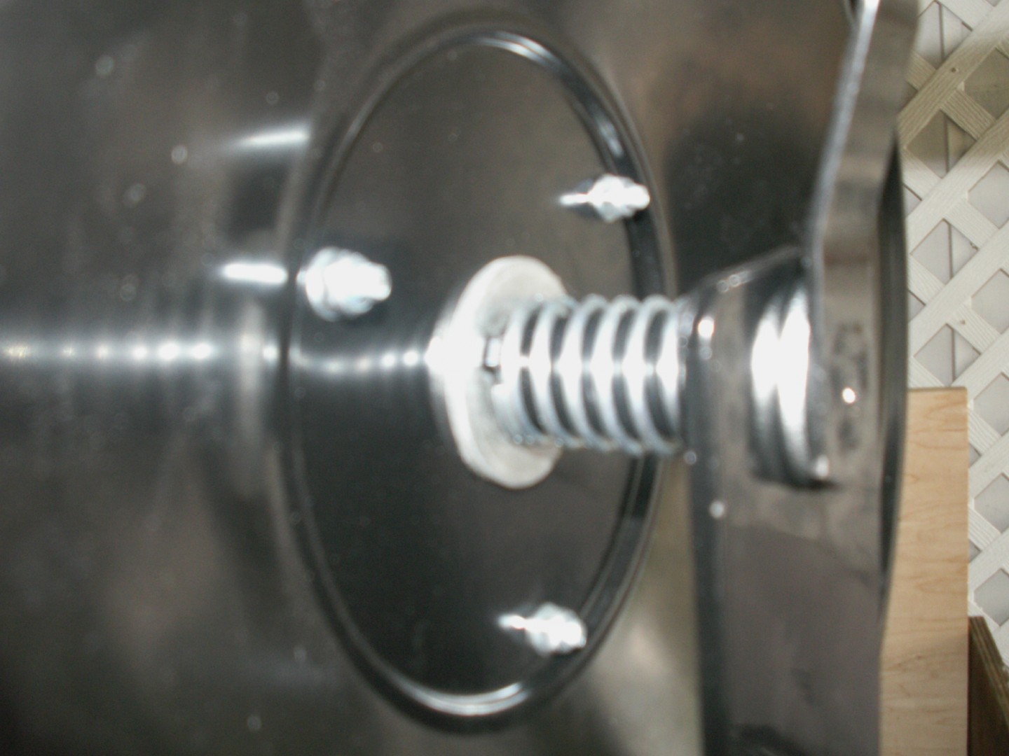

Hello folks, my next step in building up the 12 volt wash rig is attaching a hose to the reel. This connection point looks like it might be under a lot of stress. How would you make this connection? The reel is a reelcraft sold as a 1/2 inch, 100 foot capacity hand crank. I don't especially like the looks of the drum damper.
I loaded up 100 foot of 1/2 inch hose and attached another 50 foot of 3/8 inch hose. I am getting ready to see if my hybrid hose will achieve a useful quantity of flow to wash mobile homes. Thanks, Chuck

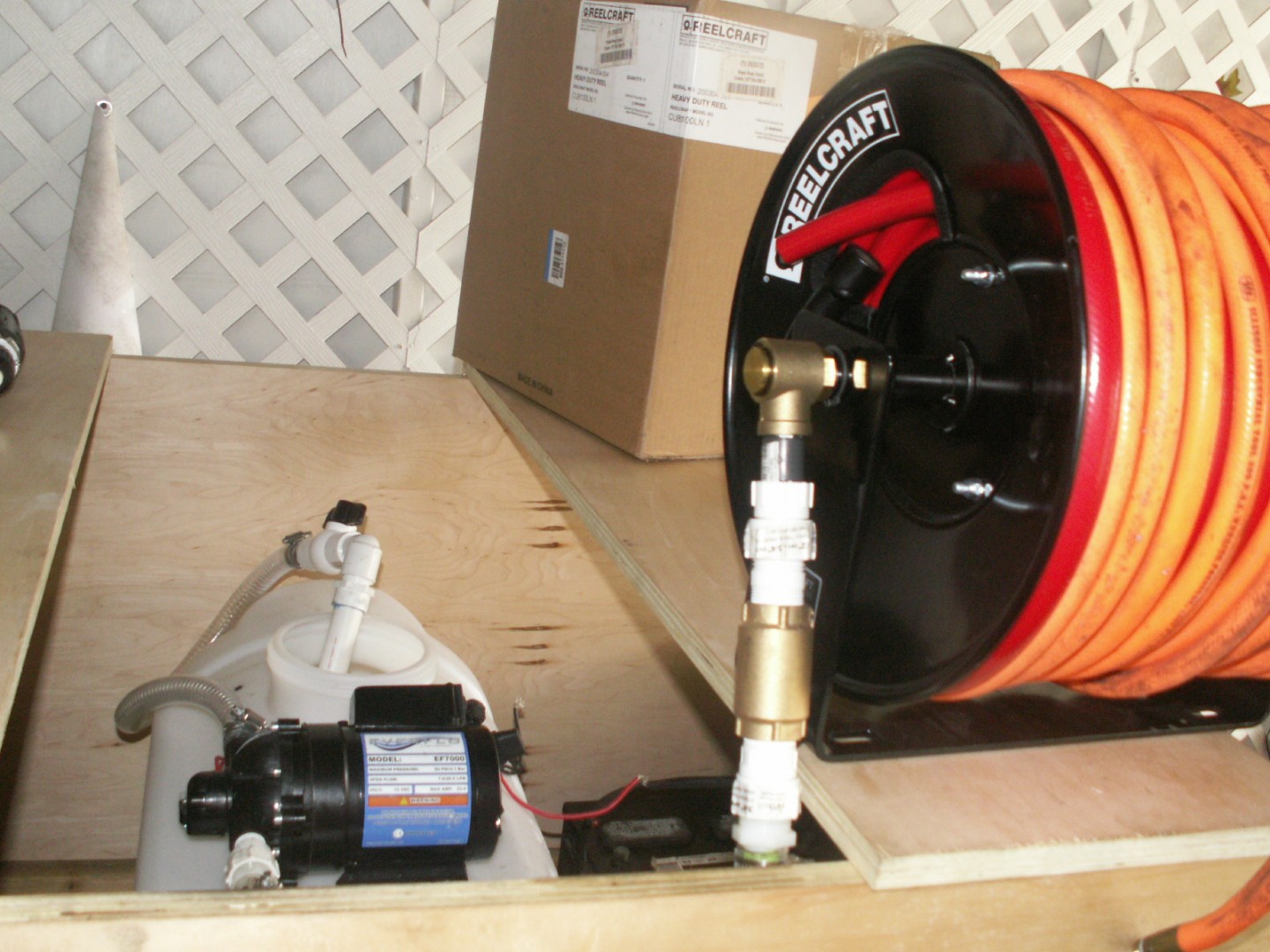

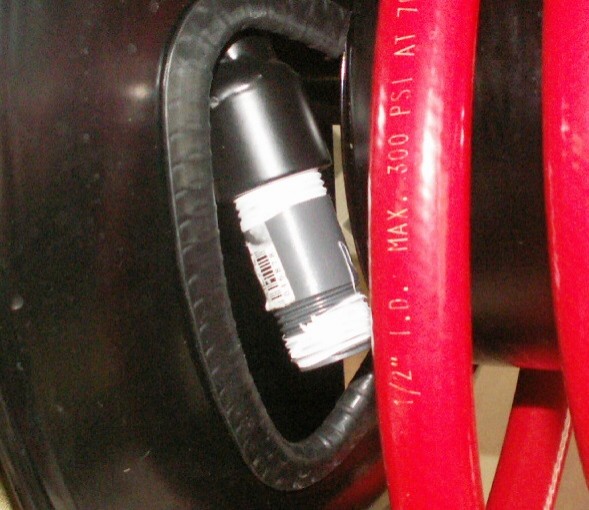

So, an update on my hose to reel connection. I found a 1/2" 45 deg. street elbow made by maxline and ordered one. I think that will get my hose to roll on the reel ok...
If that fitting is brass, make sure you rinse it well.

Hi Brett, roger that. I looked at a ss unit, but it was very expensive. I am using nylon thread tape on fittings, but I remember someone advised against it. He mentioned something about using something with the word *blue* in it. Thanks for the wash out tip. I ordered two of the brass els. Would you recommend using a neutralizer in the house rinse? So much to learn....... thanks, Chuck PS I live in Manatee County, Florida.

There's nothing wrong with teflon tape. I use Tru-Blue on just about all of the fittings. I guess the only way we could add a neutralizer to the house wash would be to down stream it. As mild as the house wash mix is, good rinsing has always worked for us.

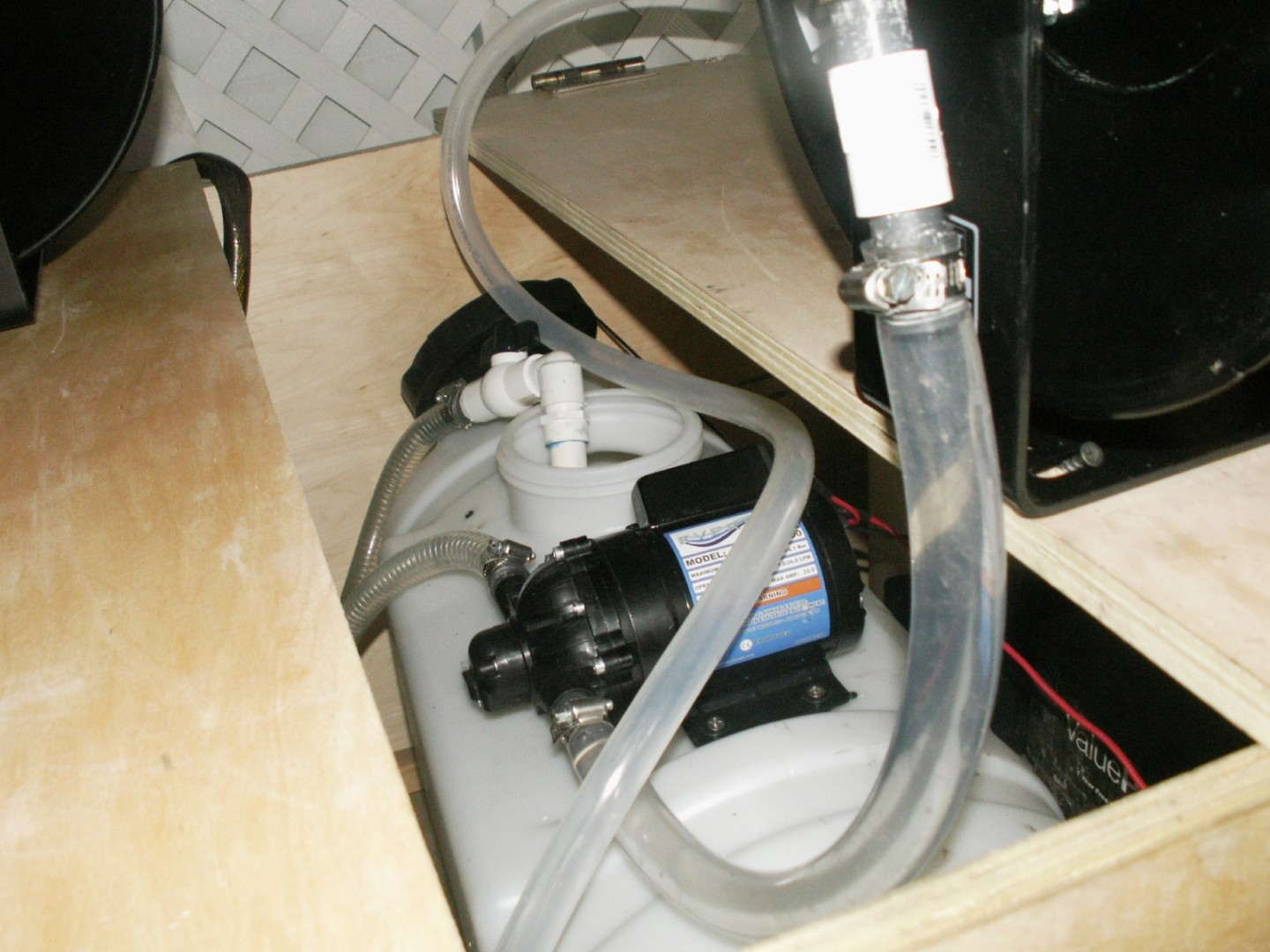

I ended up just screwing a SS hose barb directly to the reel. I checked around for tru-blue tape but ended up using standard white tape with no leaks yet. I'm still confused about selecting tips suitable low pressure systems. Is a check valve necessary, or beneficial
and if so, should it be used on the suction side or the pressure side? I guess it could be useful at the input to my rinse tank coming in from the customer's water system. I have a 50 grit filter on the customer supply reel. I can see why folks choose to purchase a complete well thought out system. I have close to $1K into the rig now which is a very basic 12 volt 1/2" system with a spare pump.

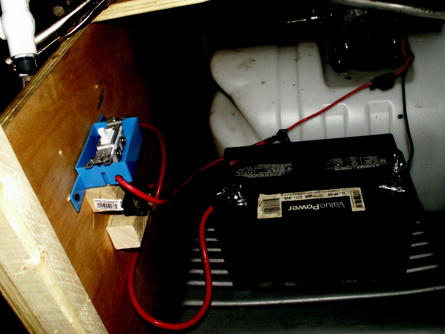

Despite a couple miss-steps, I did a pressure test today. I was surprised how much adjustment of the pump pressure switch was required to settle things down for a smooth start and stop. I mounted a light switch and connected my battery using some heavy marine wiring I salvaged. There is a 50 amp circuit breaker that I will add when I add the 2nd pump motor. Just focusing on getting a reliable basic rig ready. I have a 15 gallon tank for my batch mix, and a 25 gallon rinse tank. No leaks! Got to add a 3 way ball valve to switch the pump from batch to rinse next. Thanks for sharing experience and the encouragement.
