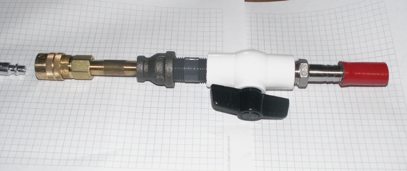

Thanks Art, I am enjoying this project. I am not looking to work until after our 100+ weather cools down, and that may be several more months. I don't believe a lot of our snowbirds will show up this year. I'm afraid lots of guys down here in Florida will be selling their water blasting equipment alright. My temporary spray gun is doomed to die sooner than later, but here is a picture, another mix and match assembly using some brass parts.

Chuck you are using air Fittings, all fittings are not created equal. You need Power Washing fittings
You need to call Lisa at the Power Wash store. She will help you get started. Keep it simple don't buy into the hype.

I noticed my fittings didn't look right when I started looking into nozzles, and of course the hardware I have is not what I need. I did have a chat with Lisa at Power Wash Store. She was very patient with me and helped steer me to some nozzles other folks are using. I got the right fittings coming now. Also ordered a 4x J rod. Nozzles: 0030, 0040, 2530, and a 2540 plus the matching quick lock connector.
