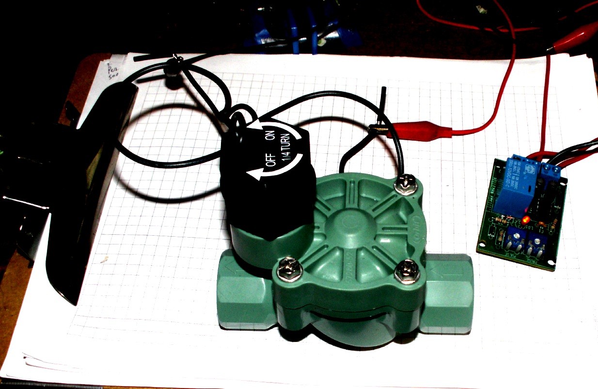

Well fellas, I am not looking to be a pest here. Over posting? However, in my little shop, I have taken a 3/4" irrigation valve and connected it to an inexpensive timer relay. I can set the on-off time of the valve. I can for example set the duty cycle for 3 seconds on, 1 second off. So, I am doing this to see what timing ratios might be useful for upstream injection with my rig instead of batch mixing. I am using a T to divide the suction line. Left leg straight to tank 1. Right leg to tank 2. Tank 2 has an electric controlled valve in series to modulate flow. I've had the valve and timer running on my desk for the past 6 hours continuously. The solenoid coil is only mildly warm to the tough. The timer relay is rated for a million or so iterations. I am paying around $3 for the timer kits, but they are available assembled for a bit more. The valve is around $12. So I plan to compare left and right flow rates. I am only doing this because I like to tinker. I'm am also looking at a cheap ultrasonic tank level sensor. My tank is only 25 gal, and it will be running dry on me. So, I don't know how appropriate it is here on this site for a tinkerer like my self to offer this sort of content, If there is any interest, I will will follow up with a report how it goes on the bench. Stay well, Chuck

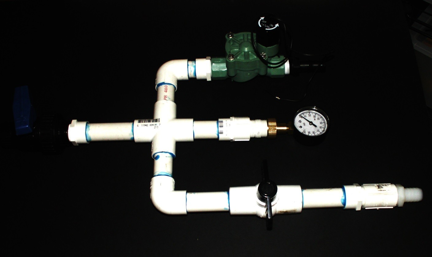

I'm going to find out Art. I don''t believe there is any metal in this valve. I am going to do the ratio pulse tests using water. I can always buy a chemical resistant valve if the mixing ratios are usable. I may just remove the solenoid from the valve and put it in a bucket of bleach for a day or two, then clean it up and test it if still functions. These valves are so cheap, you could use it a week and change it out as a part of your regular PM. Here is a picture of the test jig.
Test ended pretty quickly. My irrigation valve worked continuously for over six hours (dry) on my desk. But it turns out 12 volts DC is just not enough for the solenoid to activate the valve under pressure.. I am going to try again with 24 volts just as soon as the temperatures here drop some....
