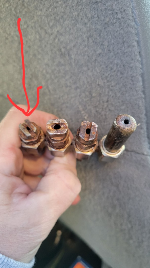

In addition to the normal softwash tips I have on a 4 banger, I also have a reduced down tip 2515 that is great for getting good coverage with less volume of water. I generally use this for second and 3rd coats on a roof and areas where I need to be accurate and have little runoff. The spray is almost that of a heavy mist.

Curious about the J rod picture. I put all the nozzles in so the spray pattern is exactly the same. IE: the angles are all in line. If I remember, I'll post a J rod set up.
Mar 6, 2022
I agree Brett,..my nozzles have to be all aligned perfectly crossways with the length of the "Banger" .

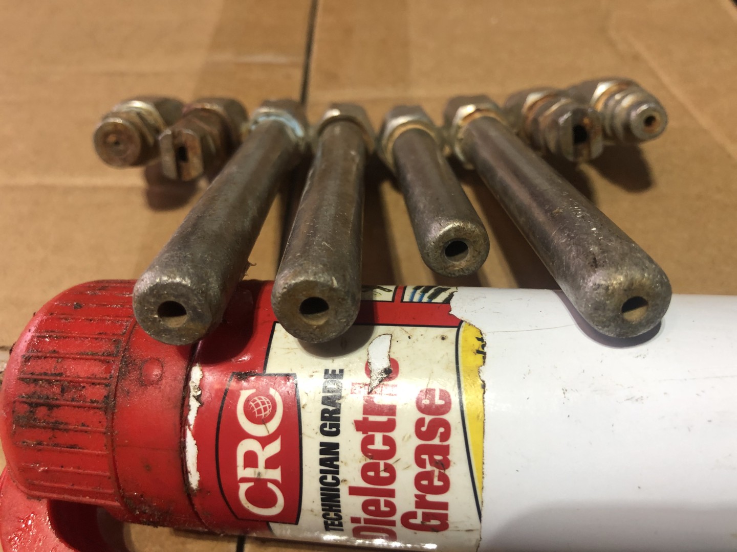

My J rods
The one on the left is Guys shoot, That's my favorite. If I lost it I would freak out. It shots the best. The #6 zero on the end I use for rinsing hard to get stains. The j rod on the left is KEC. Not as good as guys shooter, but the different tips that come in handy. Pic won't reduce
I usually have some ocd issues as well but here's the reason w the jrod.
For what ever the reason the milling on the Jrod and the 1/4 Meg nozzles are not perfect match. When I screw in some nozzles they only go in 1-1.5 turns which is not really adequate so I just tighten them as much as I can and forget about lining them up.
Funny part is, that not being lined up has no effect on the outcome of the job....🙂

Ha, Ha,..Erik,..take no offense. But you really should try to get with it, Ha, Ha,.. I know exactly what you mean by the tightening aspect and how the nozzle lines up when snugged down. That is a pain. Not sure if you use dope or teflon tape or nothing at all. But the dope I think allows for more fine tuning?? Gives a little better sealing than nothing at all if left a tad loose. Doesn't take much to seal these threads,..and maybe using nothing at all works,..I just always use a little dope,....The path of least resistance is out of the orifice, so there isn't any type of real pressure trying to escape through the threads.
*I'm sure you're used to them the way they are, and correct,.makes no difference at the end of the job.
I get it completely! I thought you might "feel offended"!
I had the same problem years ago but we use a ratchet to snug them. We always use Tru-Blue which helps. As long as you are the one using it, no big deal. If it's employees, there HAS to be a dummy proof way of doing things. At least I try to make the effort!
