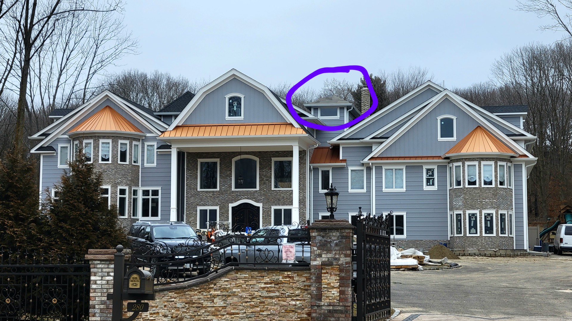

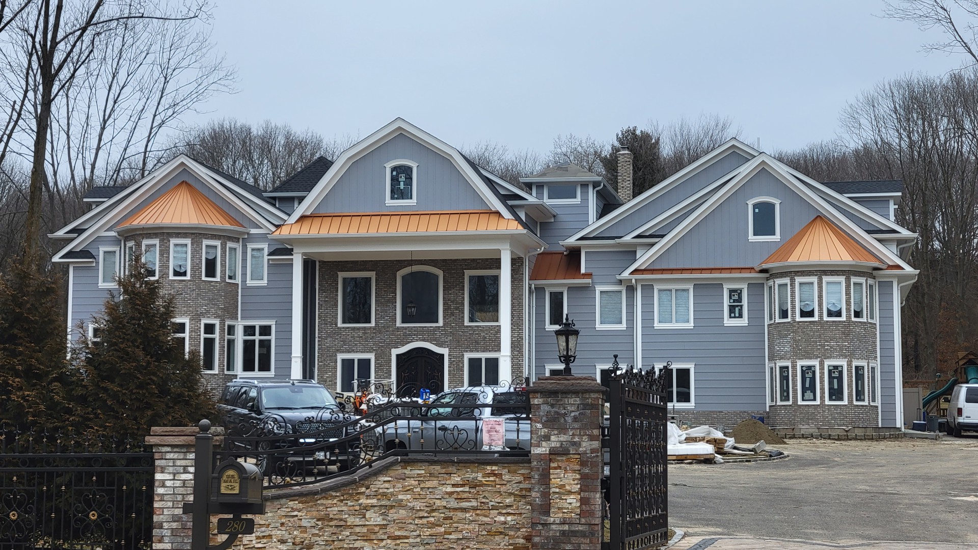

Here's a pic of a home I passed the other day. I stopped for a few minutes and just pondered cleaning something like this. Zoom in, home is much larger then it appears. 4 doggie dormers down each of the sides
A ton of ladder work to get that house clean. Definitely a unique home.

Big house. Like Brett said there will be some ladder work with that bad boy.

Regarding that huge house. I often see the same thing I'm seeing here,..(Not the size),...But the gutters on dormers and such? Why not just put big commercial gutters on the main roof and let the "top" parts just rain down into the main? Imagine the nightmare of cleaning those gutters,..or even servicing them in any way. I don't clean gutters,..and even if I did I would turn that job down.

32ft ladder is the biggest I'll use. Gonna need a lift for that house.
Jeff, I agree. Imaging having a clogged gutter all the way up top!!

Houses like this is the main reason we stopped cleaning gutters. Our tallest ladder is 36' and some of the places where they put gutters is impossible.
