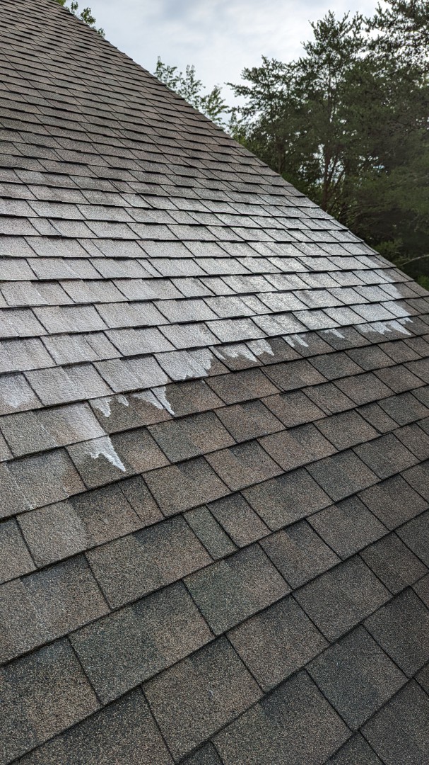

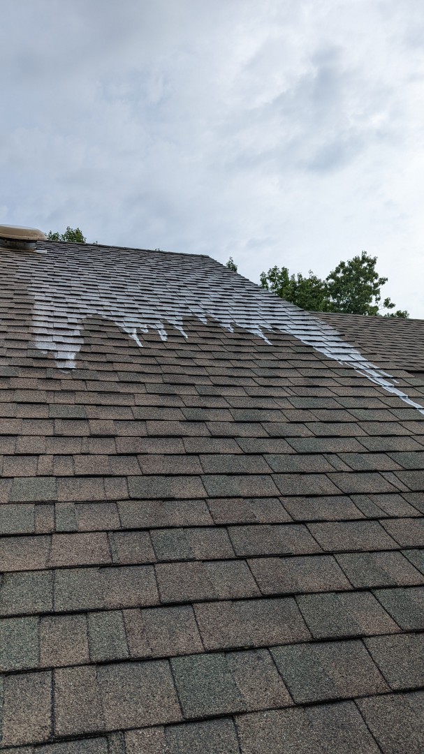

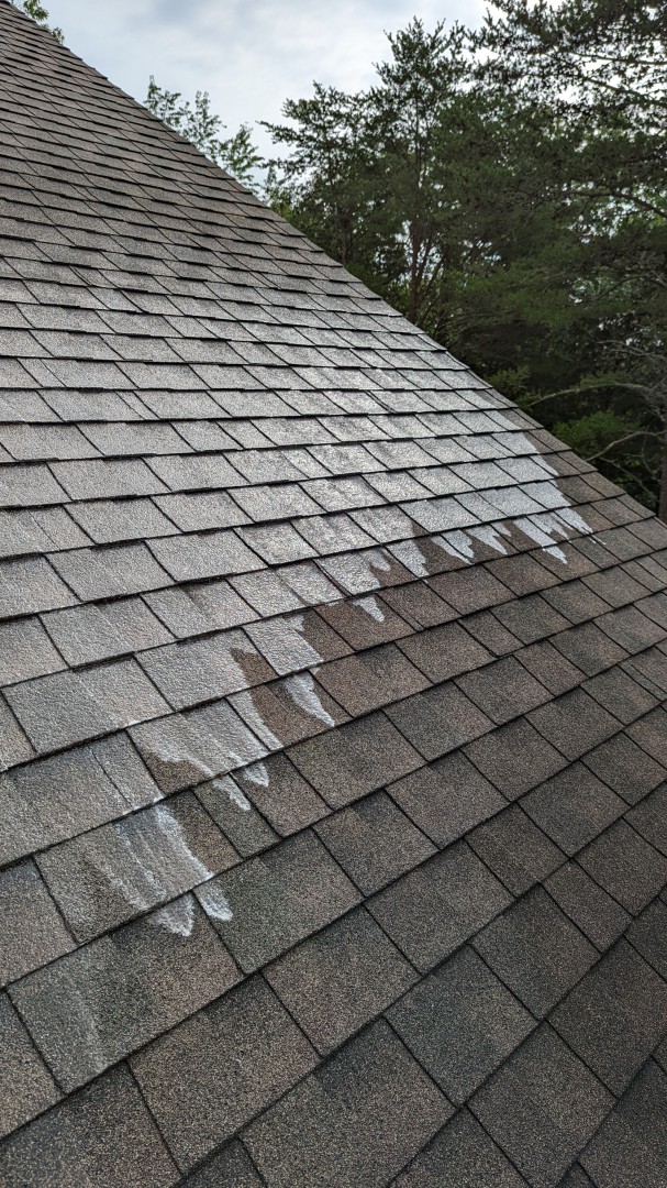

I have been working with local suppliers for years on an additive to add to the soap tank (I don't have formulas for batch mixing). We finally got some sticky stuff to make the soap stick even better, only adding around 1.5 cups per gallon. I'm willing to send anyone interested a sample, at no cost. I'll add a video tomorrow.
