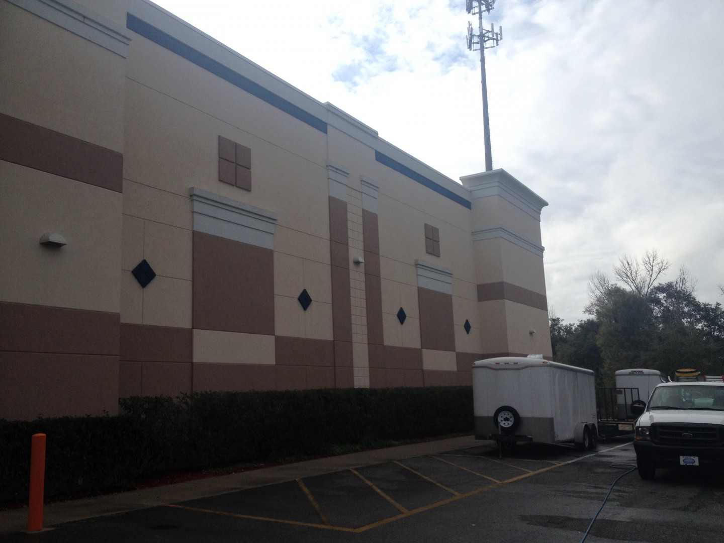

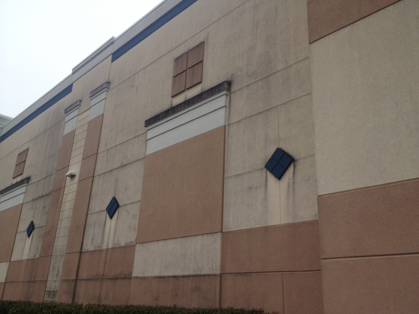

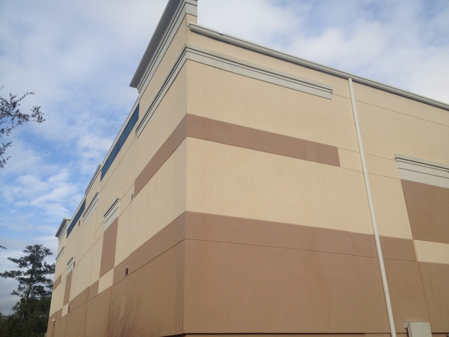

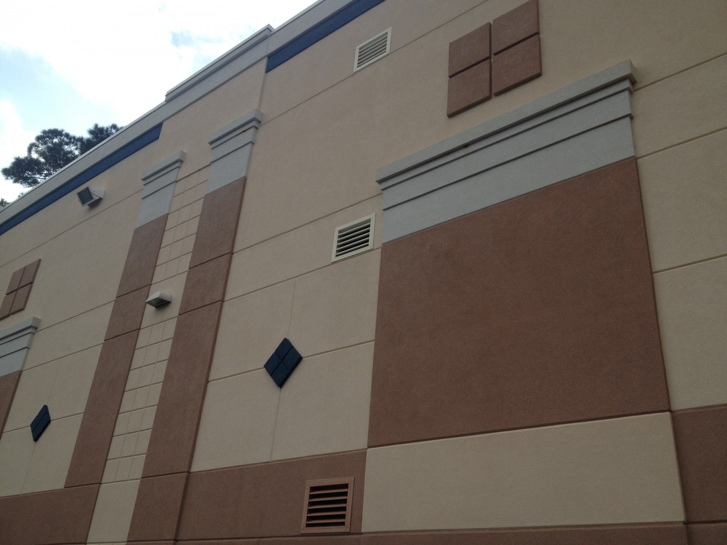

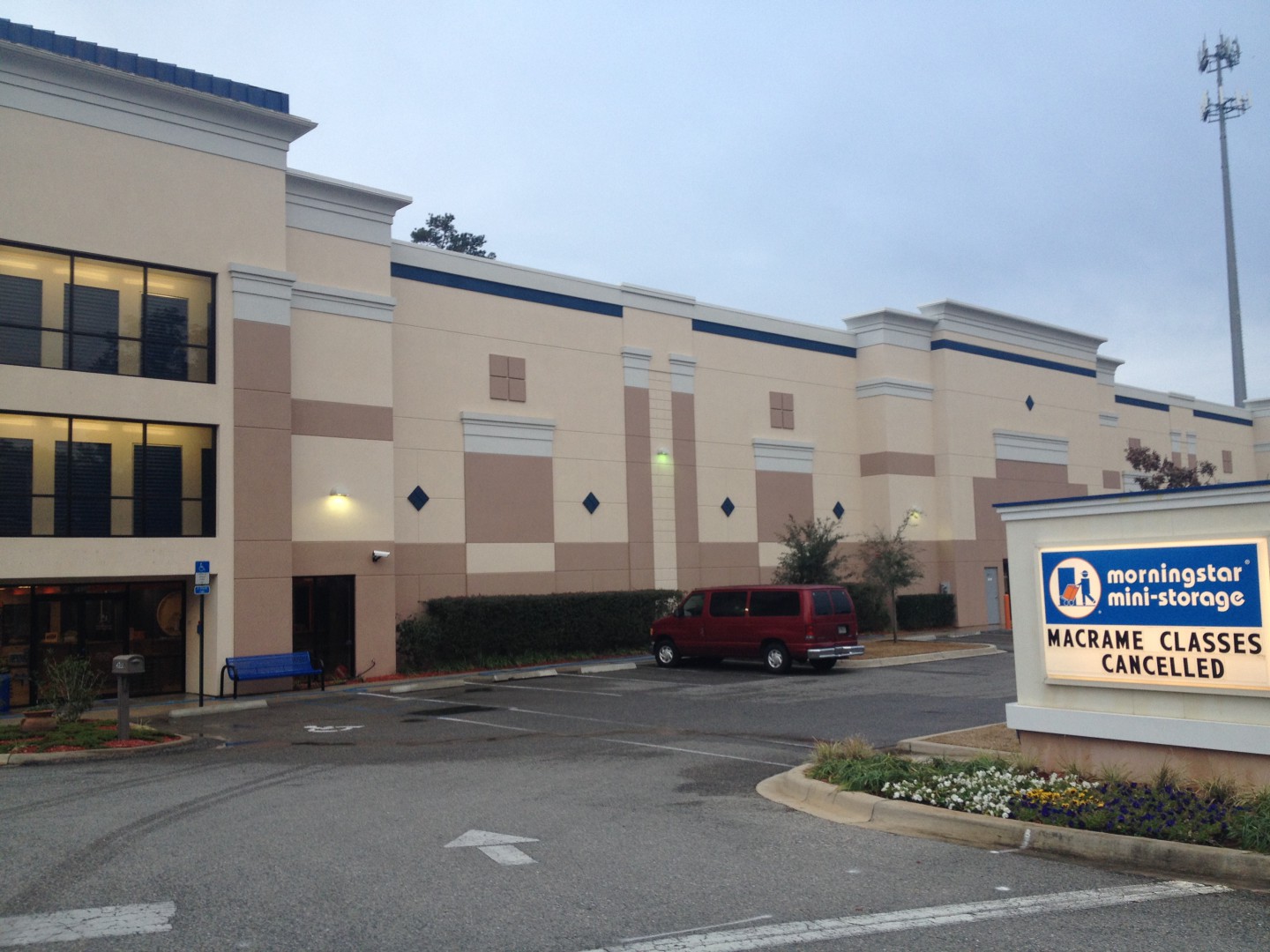

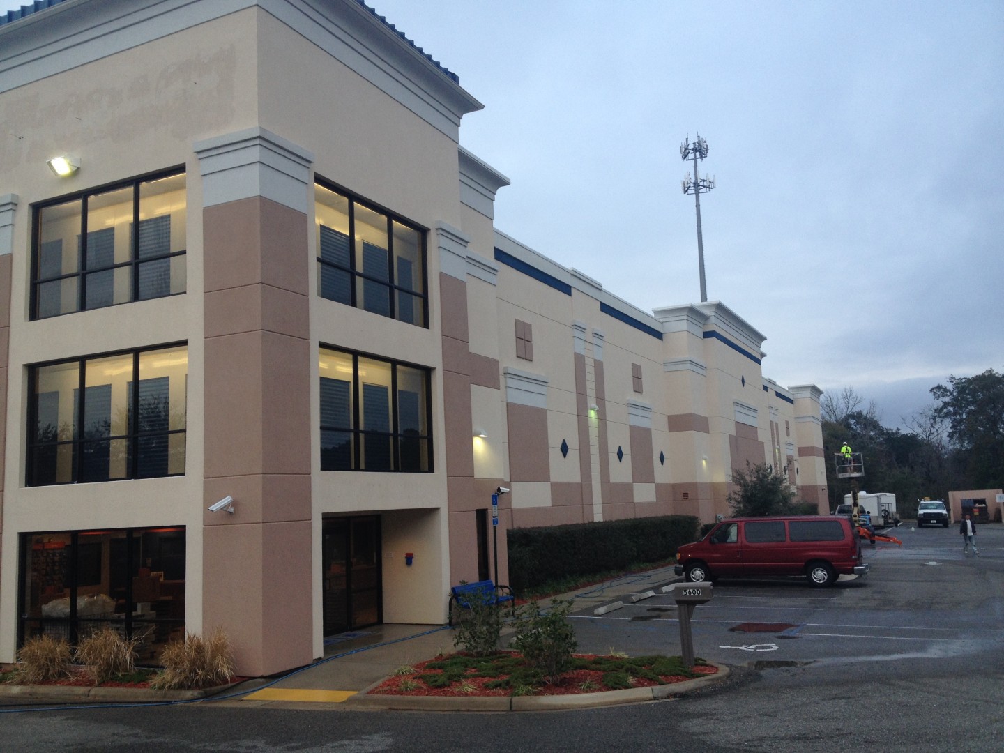

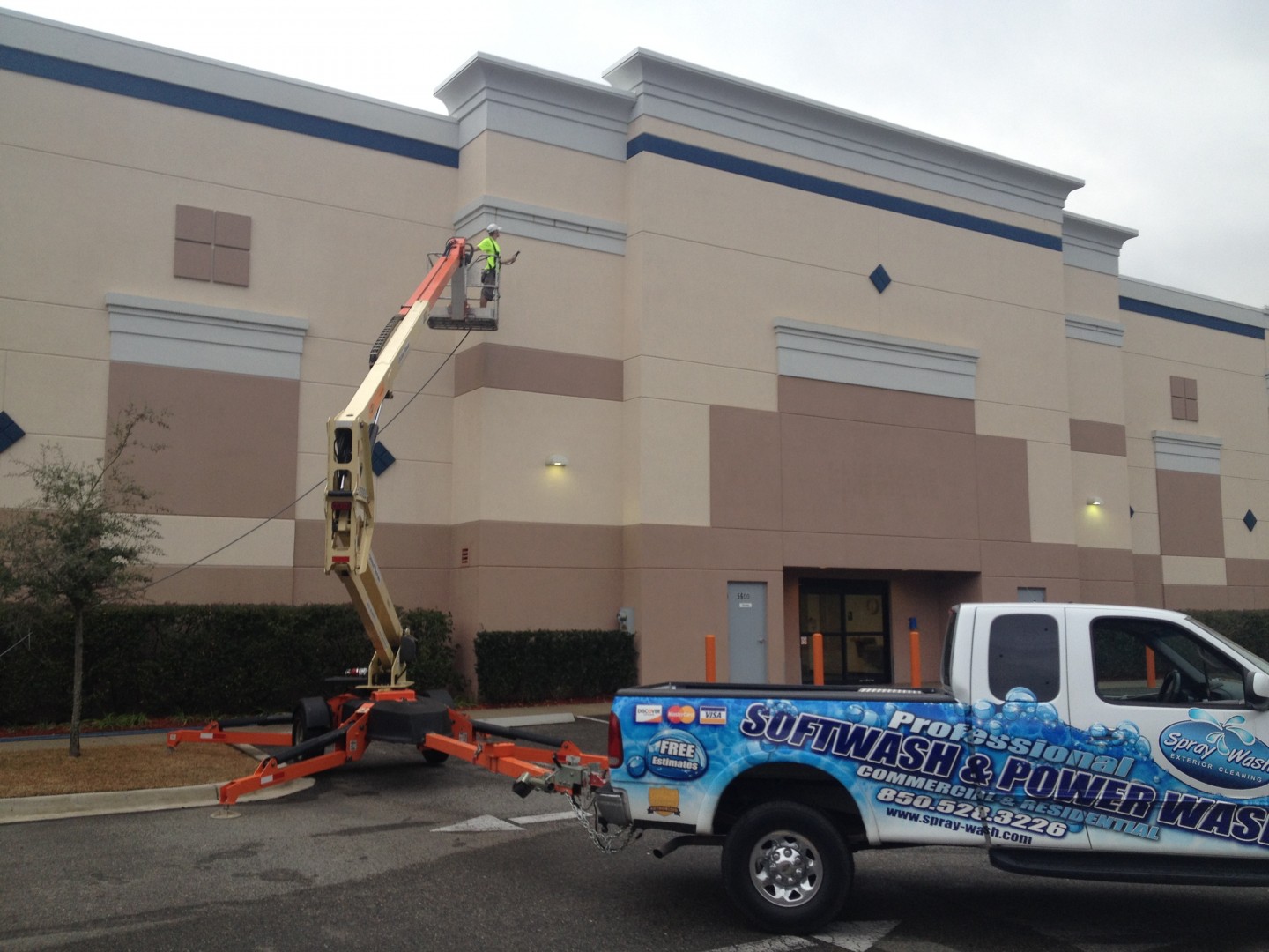

Spray Wash Exterior Cleaning had the opportunity to clean this 90,000 sqf storage facility, located in Tallahassee, Florida on February 3, 2014. The Dryvit exterior was in desperate need of a cleaning and we we able to safely, properly and expertly provide this service.
Soft-washing is the only recommended method for cleaning Dryvit or other synthetic stucco materials. High pressure can literally destroy this type of siding, ripping holes though the stucco material and introduce water into the substructure, which can cause, rot, mold,and thousands of dollars in damage!
Even though this business was open to the public, the capable Spray Wash Crews were able to clean it during business hours, making sure the public stayed safe (and dry) during the process!

Nice work Ray. It looks great!

Ray the results of the softwashing on the dryvit is amazing.
