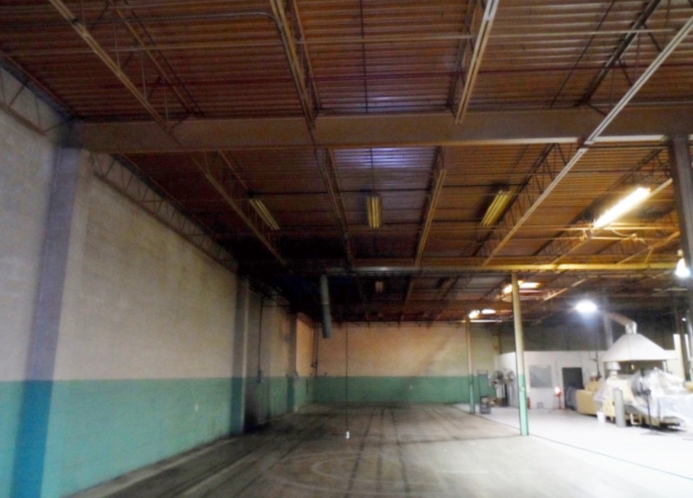

We rent office and shop space at what use to be a Corning facility now owned by Matt's Cones. Matt approached me and asked if the ten years of cone residue would come off with a soft wash treatment. I did a test spot and found that it would do a fine job. We cleaned the ceiling and walls of one area and will do the rest of the manufacturing space when he shuts down in December/January.

No pressure, just chems? Looks much better!

Brett that came out real nice.

Thanks Andy & Mike. It was an experiment that turned out very well. Everyone was happy with the outcome.

Very nice work !!!

Nice and clean. Good job as always Brett

Looks awesome! What percent mix did you use?

Where there an issues with ventilation or lack thereof?

There was a small amount of ventilation but not what we would have wanted. Respirators and good sealed goggles is what made it work.
I started out with a roof mix which is what I used with the test. It was too strong due to ventilation reasons. I found the best way was to cut it down to about 10% and apply two light coats.

Nice job Brett! What is cone residue?

Cones are made in a long conveyer with many waffle irons. They cross over some gas burners so the fumes go up into a hood without a fan (one is going to be installed). What doesn't make it into the hood goes to the ceiling. Whatever is in the waffle mix... sugar, caramel, etc. goes on to stick on the ceiling.
