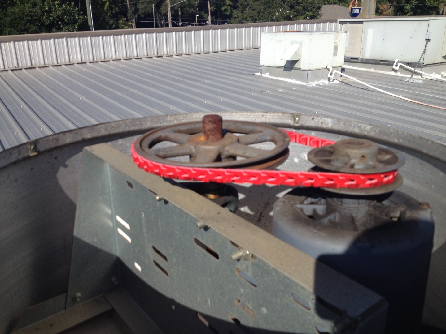

There are lots of little add on services  when it comes to hood cleaning. Pictured here is a belt replacement and a bearing grease job.  The belt was $125, greasing the bearings cost $75. I spent 20 minutes on the job.

I see you are using belts that you can make to size on the job. Keep an eye on them. these type of belts are meant as a emergency fix. They do not last very long. I have used them 100's of times in industrial maint. to get machines up and running until the proper belt could be installed.

Dave, i know what you're saying about those best, but I've seen them on Ventialtion fans that are two years old! Typically its only about a 1/2 HP motor so not putting too much stress on belt!

Car fan belts would do that job for a long time if you can match them size and v angle ...cheap little car size . .
