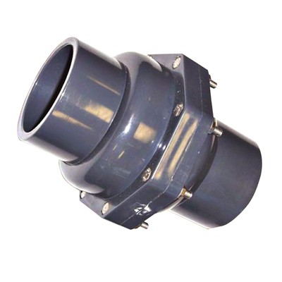

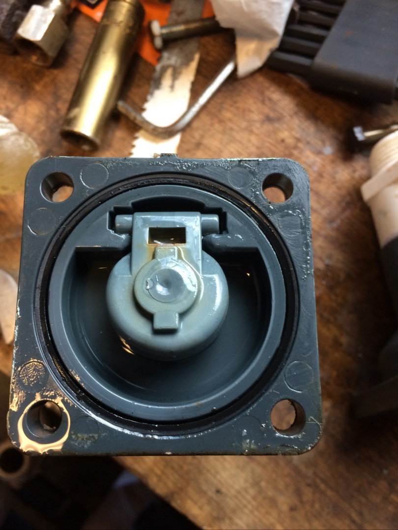

This is the inside of a Check valve for a mixing Proportioner that I built last winter. It's a zero restriction check valve with EDM rubber seals. I put about 2500 gallons of straight S/H threw it. As you can see there is nothing wrong with this valve after a full season of use. I got it from US Platics

That's impressive. 2500 gallons is large amount of SH

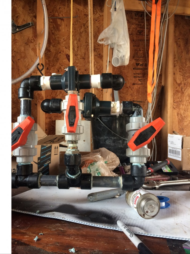

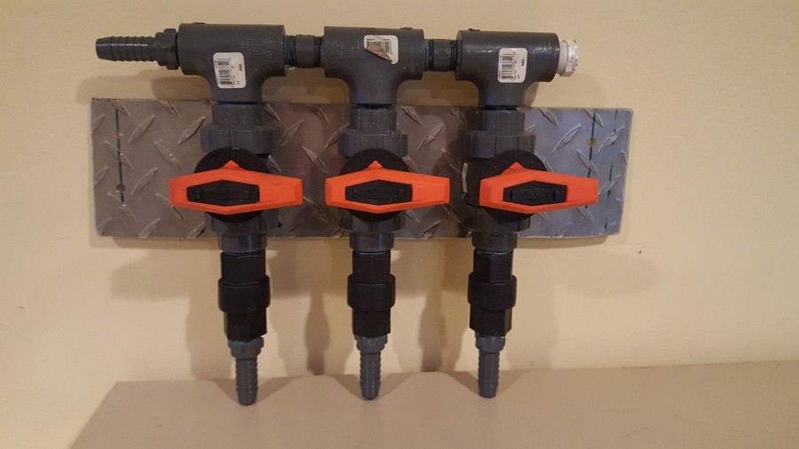

I moved this thread to the Back Room. I don't want to step on anybodys products, But we have been building our own stuff for years and there's no reason us to stop now. Heres some pictures of the manifold that I have been using since last year. The check valves have been working mint. With this setup I don't turn the water on full because I find the pump stalls. What I also like about this is I can adjust the flow so the Fat Boy cycles less.

Got the manifold installed on my skid. The valves are set at 60 x 40 mix. This is the way I have been using it all year and works fine. I went with the cheaper discontinued GIP  valves from Ebay. I will see how they work and change them out later if I need to.

I haven't tested it with Air or a Boaster pump, But I bet it will work better then anything out there. It has Zero Restrictions. Just straight flow all the way to the pump.

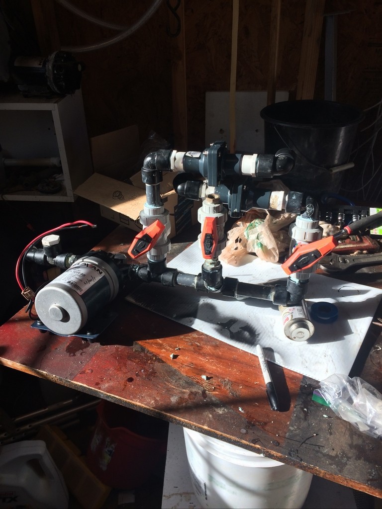

Been working on my Manifold for my 10 GPM Booster pump that I will be ordering soon. Went with Schedule 80 and liking it. Makes for nice tight seams and its thicker, stronger and cheaper then the Bango fittings. Its going to work out good when its finished

Art what size are those valves? The middle one looks smaller.

Middle is 1/2"for soap. I use the 3/4" for S/H and water because the check valve that I use is 3/4". Everything worked fine last season with my Fat Boy and the Booster is 10 GPM so it should work just as good if not better.

They are not metering valves. I bought $20 discontinued George Fisher valves on Ebay. I blind dial by eye. Once you get it figured out its easy. You can mark the side of the valves with a magic marker if you want

This is the inside of a Check valve for a mixing manifold that I built last winter. It's a zero restriction check valve with EDM rubber seals. I put about 2500 gallons of straight S/H threw it. As you can see there is nothing wrong with this valve after a full season of use. I got it from US Platics
   Rule # One, Take the Packing out of the inside like I didn't. I realized it before I glued the second one in and was able to take it out

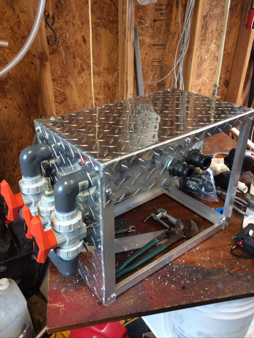

Hooked up the check valves today and I'm about done. Just need the Booster
