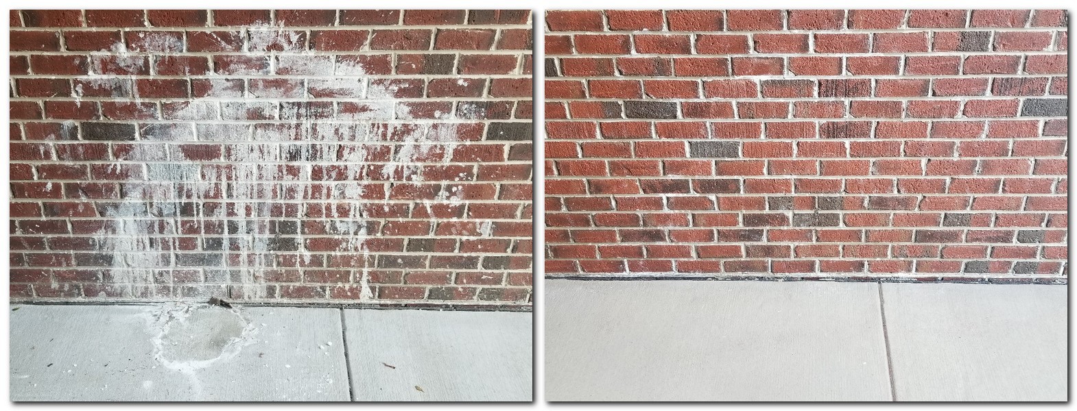

One thing we do, is always find a way to help our customer!
Post cleaning Archer at Brookhill Apartments in Charlottesville, VA for Breeden Construction, we find all sorts of things left by subcontractors. Thinking outside of the box, we got the entrance to the breezeway looking new again!

looks great, what did you guys use on that?
 It was coated with paint remover, a few coats about 15 minutes apart. Brushed it with a stiff brush, then pressure washed with the 4010 nozzle and hot water around 180 degrees.
