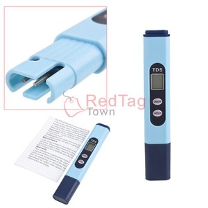

Posts: 5165
Get your PPM tester today
Digital LCD TDS Meter Tester Filter 0-9990 ppm Water Quality Purity Test Set
  • Digital LCD TDS Meter Tester Filter 0-9990 ppm Water Quality Purity Test Set
  • Condition
  • New
  • Time left
  • 21d 8h 57m
  • Shipping
  • FREE
  • Brand
  • Unbranded
