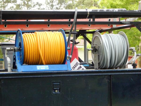

I'm doing the build out this weekend to be ready for Monday's job. A standard PU truck just isn't enough for all we do and after seeing a few pictures of Eric's rig (Liberty Soft Wash) I had a few more ideas. I'll be mounting both hose reels on top of one of the side boxes and just have two tanks in the back.

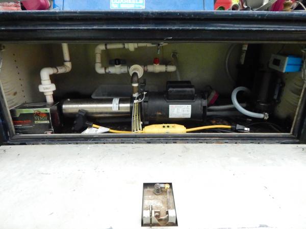

I won't be using a "skid" at all. I'm going to devote one of the boxes to hold my residential pumps as well as my commercial RBP pump. I'll run it so that we can just hook a water line to the truck and be able to boost pressure or shoot a mix. I'll put two batteries in another box as well as an the off/on switches for all of the pumps.

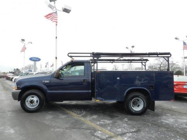

I "stole" this truck........$6,000 with 66,000 miles. F-350 with a lift gate (need for my kids school stuff), rack included as well as a rear spot light and new tires. Everything else I found was near 200K miles or just too much money to turn over to employees......just need to wrap it with our signature green after the build.

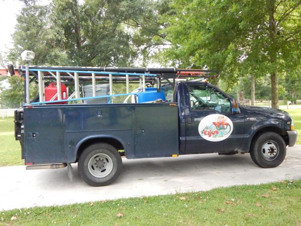

The build is actually great but we are staying booked out 6 weeks so I just don't have time to get a wrap.
Also we were swamped and my garden hose reel pooped out so the truck is a mess for the pictures I took today.......

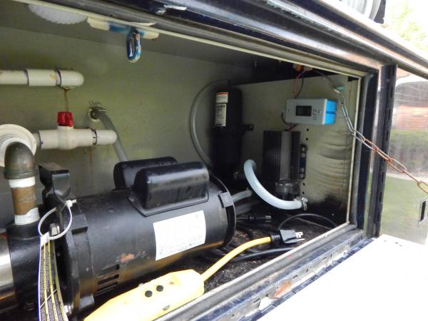

I put my RBP pump and my 12 V pump in one of the compartments with separate valves to switch from mix to water.....works awesome.
In fact I just bought another RBP pump that is sitting on the floor beside me because this one is about 6 months old and that is about when they take a dive. Everything is set up to easily swap out on the go. My battery is in another compartment along with a charger because I have not had the time to hard-wire to the truck.
I have two 55 gallon drums near the cab. One for SH and one for my mix. I will be putting in another tank because sometimes we will shoot the roof and do a house wash at the same time but can't use the same mix.

What is the black box mounted to the wall behind RBP?

There isn't anything black mounted behind the RBP Pump.....just the valve assembly I built. To the side there are two black things. One is my 12V pump and the other is the accumulator for the 12v pump.
It really is pretty slick and easy to operate. Allows us to do residential and commercial....roof or house wash or anything else we want.
