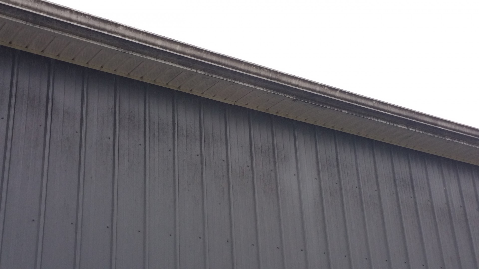

Last Friday The Roof Wizard's crews softwashed a local winery, Plagido's Winery, which was infested with black mold. I got the call from the owner as a referral from another winery owner, who's building we cleaned last year. He explained that his customers have been commenting on the nasty black mold on the building and he needed a solution. He was very concerned about using too much pressure and had not done a real cleaning, since the winery was opened in 2007. We softwashed the entire building, in two hours, first thing in the morning, so they could open at noon and not cause a disruption in business. We then went next store and softwashed the owner's roof & house. As you can see from the pics below, the winery is clean from the black mold & algae.

Awesome job John. What was your mix ratio and what products did you use? :)

Thanks AC. We used a 1.5% mix with Green Wash, then we rinsed. We followed that up with an application of Bleach Wash and another heavy rinse, to give everything a nice waxEd shine.

Absolutely Beautiful! I can't believe the differance on the metal building! What was the dwell time on the cleaning solition?

Thanks Pat..We used a 1.5% mix with Green Wash, then we rinsed. We followed that up with an application of Bleach Wash and another heavy rinse, to give everything a nice waxEd shine.
Dwell time was about 60-90 seconds.
