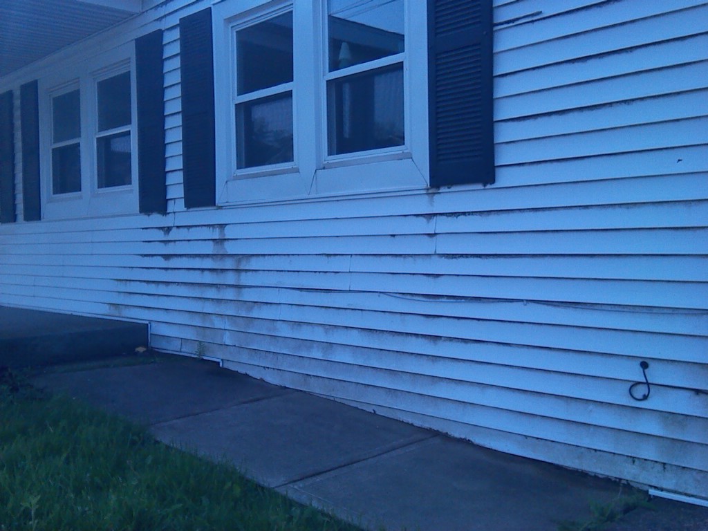

Vinyl siding troubles
Some before pictures of a cleaning job we did. Spent to much time cleaning this house and decks, couldn't just spray on and rinse off had to power wash everything. House has been sitting for about 5 to 6 years with nobody living there. Hit the siding with 3% SH with some gain in it. I think i should of went with a different mix.

I think you may have bad bleach. I've had that problem a time or two lately. You should have been smoking that algae off the house with a 3% (assuming you mean 30%) and Gain works pretty well, actually. I use a 1% mix on vinyl. I literally just get it wet and let it dwell then rinse. The algae dies almost instantly.

We see this type of conditions very often around here. A 3% mix should have done it. Worst case... a reapplication should have done it for you. Perhaps you could share how you mix your chemicals and how you applied your mix(dedicated pump, downstream or x-jet.) Was your SH hot when you got it? What was your dwell time? The more info you share the better so we might help you.

Are you using Clorox?

3% should rip the algae off and is way too aggressive for vinyl siding. Art's question makes me wonder.....Did you use Clorox and if so did you dilute it at all?
When you say 3$ do you mean you started with a higher concentration then diluted down to 3% or is 3% what the bottle said?
Gain is an awesome surfactant. Sticks well and rinses off windows even if dried on.
Posts: 1224
What the bottle Says percentage wise does not mean what it really is as SH degrades due to time and heat, UV etc.
5% on label may be 1% by the time used.

I do have some Superchlor it's 12.5% to 15% but i didn't use it. I was in a hurry and i picked up some concentrated bleach from Lowes and cut it in half.
I see it didn't work like i though.
