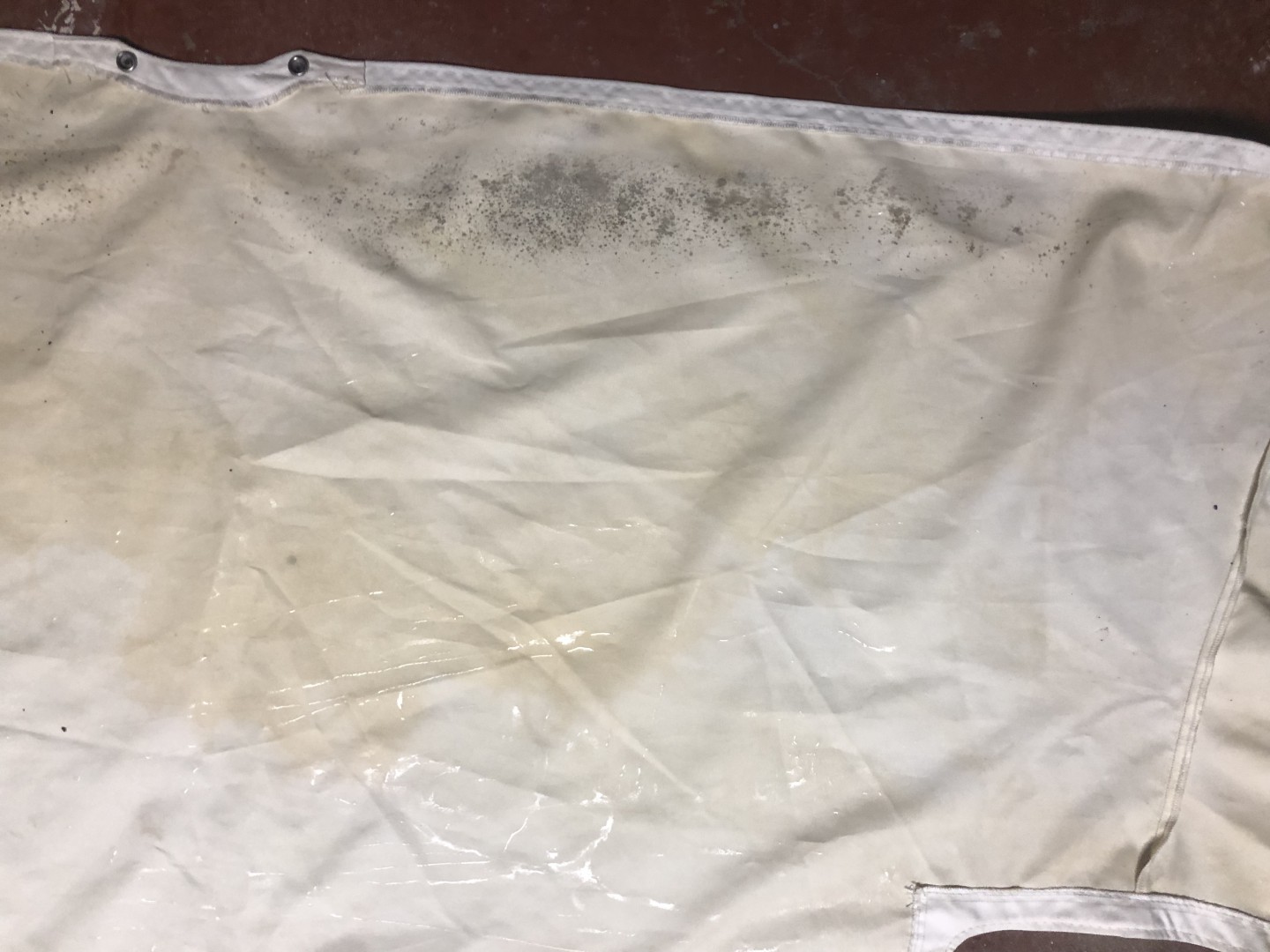

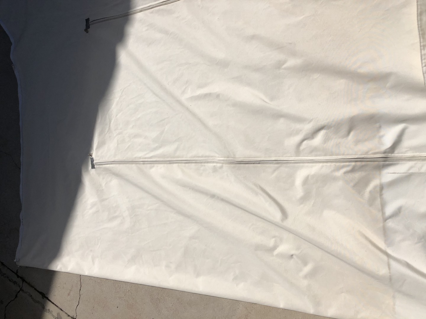

Paradise Pressure Washing received a call this morning to clean some boat awning. We swung by and grab them on our way to a job and softwashes them while doing the other job. Customer was pleased and asked us if we can dye and clean more for them. I have never dyed an awnin but don’t believe it’s to hard. Any thoughts would help.
