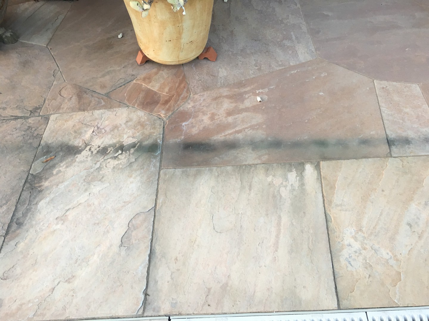

Hey Guys,
I am doing some work on a house that has bronze stains from some architectural bronze arbors. The stains are on flagstone.
I tried a roof mix and Ultra One, they didn't touch it. I am avoiding F9 Barc if possible because it leaves a bright spot.
Any suggestions?

Copper Stain Remover
They also have a process to remove heavy stains with Poultice Powder to mix with the gel for more stubborn stains.
My guess is, it should remove the bronze stains.

I know this is an older thread but I have removed the bronze and copper stains with One Restore from EacoChem.
This has worked great on brick, concrete, stucco and some other surfaces but I have not used it on the stone like in your pictures.
I just wet the surface some, spray it on non-diluted and the stain disappears.
