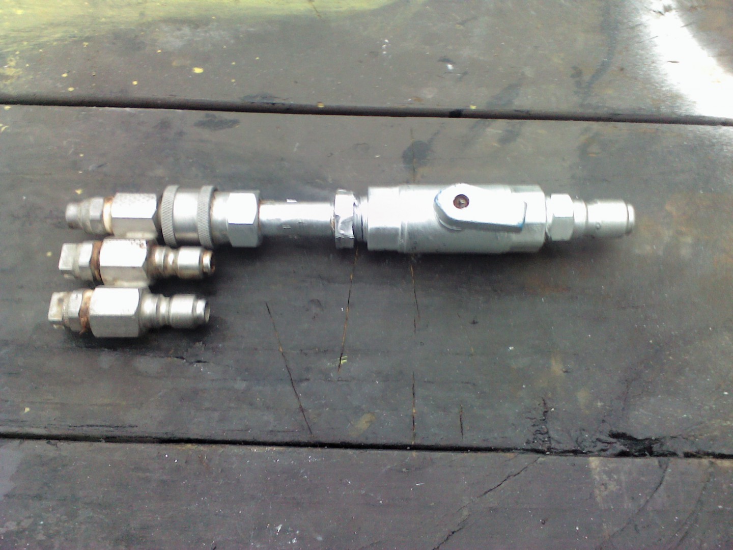

Here are the ball valves I've been using for applicators. The short extension in the last photo is actually schedule 80 PVC. PVC can be bent to a desired angle with a little heat from a blow torch. And can be with a basic 1/4" coupler. You just have to bevel the edges to get the threads started. The short extension in the first picture is also pvc, threaded right into the ball valve.
Next to last photo is the one I use for roofs,...3/8".
The little green cone nozzle on the spot sprayer is an end you can buy at TSC,..they screw into the 1/4" a little funny,..but I have no issue with them leaking.
On the 1/4" valves,..I add a little "T" and plug the side port,..I do this simply for a bit longer handle,..and I like the shape the "T" gives ,..feels good in the hand.
These things last a long time...and are cheap to make.
Very smooth operation and is EASILY operated with one hand.

Those look good and easy to use. I guess you can just use your thumb.
I have been using this set up for eight years and the guns last a long time. We use the same gun for everything, 12v, booster and our portable for spraying chems for deck stripping.
Hey Brett,..I never had good luck with those triggers,..they always started weeping after only about a month. I took them apart and checked for debris in the seat and all,..but they just didn't last for me. I made sure I got the Viton model also. I used about (4) of them just in case I had a dud or two. I know many guys use them,..but even with thorough rinsing,..just didn't suit my needs. I got away from trigger wands altogether. Also,..I paint all of my pieces and parts,..black or silver,..the Krylon over the PVC and then clear holds up amazingly well.
*Wonder why they don't put Hastelloy springs in those things,..Teflon seat, Hastelloy spring and ceramic ball,..would make them better.
Yes,..just the thumb is needed to open and close, turns into very second nature. I only replaced one of them last season,..and that was due to the little screw that holds the little switch thingy on,..it rusted off and made the ball valve useless. But it was the one on my cart sprayer that sits outside all the time on the trailer. Th others are inside and never had an issue with them.
