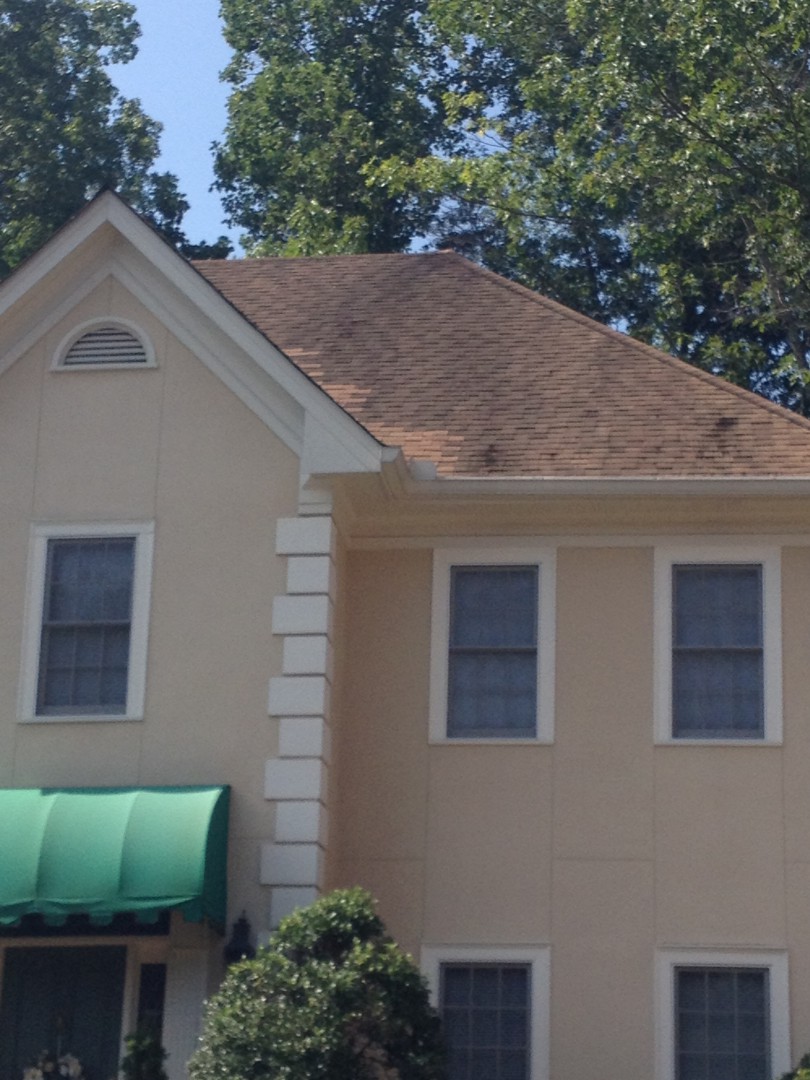

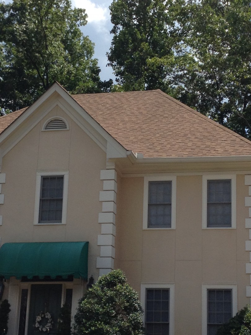

Pat started a thread about foam shingle cleaning and rinsing and I'd like to comment on rinsing with normal Soft Wash applications.
In the past, we have laid down a pretty heavy coat of Soft Wash mix when cleaning roofs without rinsing (with awesome results). The run off was somewhat heavy but we irrigated vigorously to dilute the mix as not to harm any vegetation, specifically at the downspouts.
After Soft Washing roof shingles, we never rinsed unless it was for a realtor who had a showing that weekend or a photographer to take pictures for a listing. When we didn't rise, it was very common that there was a light brown residue from the dead algae. On some residential homes, the light brown haze was noticeable on the roof shingles that had heavy algae infestation after we finished and the conversation to the homeowner was that after the first good rain it will wash away. Was this a "splash and dash" tactic? Absolutely not. It is a fact. After a solid rain event, the final results from our Soft Wash cleaning was crystal clear!
This year, we started applying two light Soft Wash coats instead of one heavy coat. It has been done in the past by other contractors and we tried it this year and it works! We use less Soft Wash solution, we have minimal runoff and the light brown residual color from the dead algae is non-existent when we drive away.
To those not doing this, give it a try on a small roof when your day is not booked solid and post your results here.
