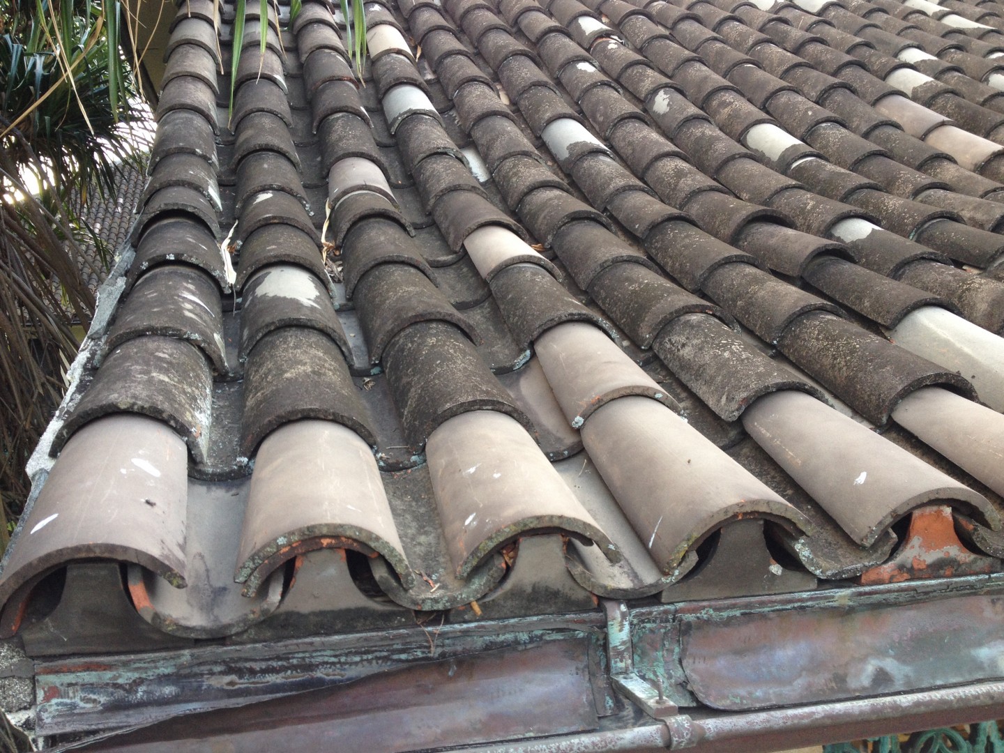

Any suggestions on this roof?

Is it worth my time? that stuff on top off tiles is caked on

Chris,
What roof cleaning (soft wash) system do you have in place?
Yes the roof is in bad shape but I do believe it can be cleaned. You going to spend some time there for sure with a hot mix.
I see there are copper gutters and you're going to need to be careful with that and the surrounding plant material.
Another thing I noticed is the larger than normal gaps between some of those tiles.
Vender
Posts: 831
What Hank said and on Jobs like that I do a couple test spot's.

I have a demo set up for next week.

Chris,
How did this demo go? I can't take the suspense.

Sorry they postponed till the 9 I'll let you guys know

Demo went great, they were sold on softwashing. Used a hot mix 3 coats melted like butter.
