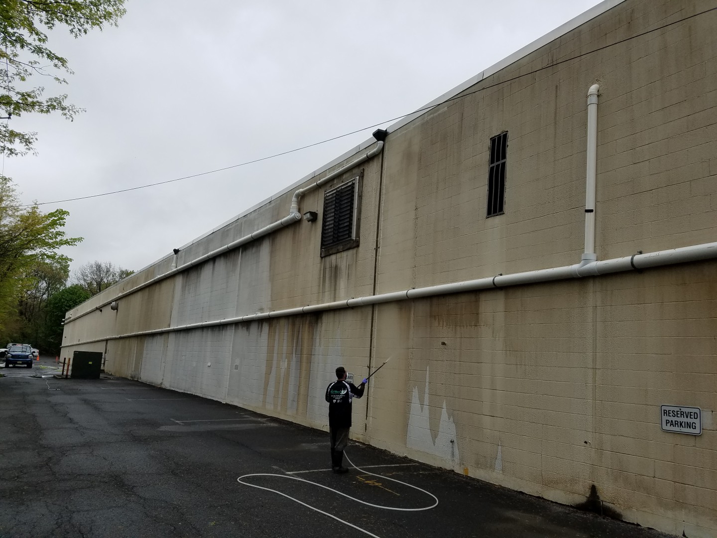

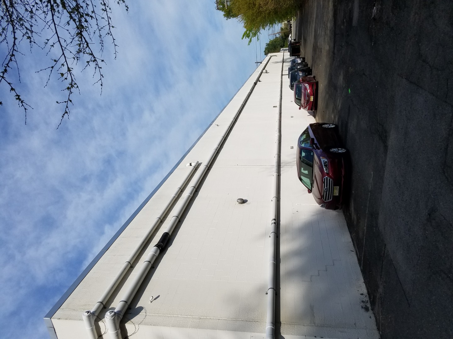

Warehouse Cleaning New Jersey....
Here is a warehouse that we softwashed this past week for property manager. We also did the one next to it yesterday as well. Lots of grease and dirt, and a little algae. They wanted it cleaned but did not want to use any pressure, because the building has had some leaking caulk joints. We sprayed the majority of the building with a 2% mix, but bumped it to 3% for the one really nasty side. Lots of degreaser in the mix and the booster pumps were a huge help, since we only had two water sources.

Another fine job!

Proof that The Roof Wizard is the go to cleaning "Wizard" in New Jersey......more than just roofing. The Roof Wizard is an all in one exterior cleaning contractor serving both residential and commercial clients and with the before and after pictures it's plain to see why NJ loves your exterior cleaning expertise!

Nice John

Nice.
